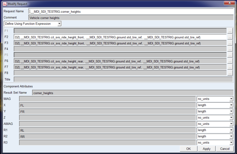

There's one more question. (They never seem to end):
When performing SVC simulation I get front and rear ride heights. I was searching hard but could not find HP, Marker or CFR it is tied to. How can I find coordinates of this front/reae RH points?

Can you help with this one? When performing SVC simulation I get front and rear ride heights. I was searching hard but could not find HP, Marker or CFR it is tied to. How can I find coordinates of this front/reae RH points?

The ride heights are relative to the hardpoints you put in. So if you put in all your hard points at say curb , but run svc at 2 up, the wheels move up relative to the body, and for some reason svc reports that as a negative value. I think it use the wheel centre marker, for this, check the adm if you really want to know.
The main use of this is to allow you to set your spring preloads up so that the vehicle rides at the correct height. Another way is to run SPMM and look at the wheel force curves but that takes forever in comparison.

Thanks. I understand that but I can't figure out which exactly point (and its coordinates) is used in TR car in shared directory which I used as a base for my model. To know if my model is setup at design height I have to know this ride heights are measured on the chassis part...Can't fined it.
"The ride heights are relative to the hardpoints you put in. " I didn't put them but I wish to know how to find where ADAMS did. I would preder to move it to actual points used when setting the car up on the scale pads.
"check the adm if you really want to know." - would you please explain what does it mean? What is adm?

But I think that this is not request used in SVC ride height measurements:
Wheel hop natural freq. Hz 18.67 18.67 18.67
Wheel tramp natural freq. Hz N/A
Front ride frequency Hz 2.35
Front ride height mm 189.48 189.11 189.85
Adams Model Title:
<private>/assemblies.tbl/GT4_3.asy
REAR SUSPENSION CHARACTERISTICS
Suspension Description: <private>/subsystems.tbl/GT4_Rear_v2.sub
_________________________________________________________________________
(PARAMETER) (UNITS) (AVERAGE) (LEFT) (RIGHT)
Unsprung mass (total) kg 50.00
Unsprung c.g. height mm 328.25
I think that this “Front ride height” is taken from this request:
adams_view_name='testrig.corner_heights'
REQUEST/484
, COMMENT = Vehicle corner heights
, CUNITS = "no_units", "length", "length", "no_units", "no_units", "length"
, CNAMES = "", "FL", "FR", "", "", "RL", "RR", ""
, RESULTS_NAME = corner_heights
, F2 = DZ(763, 1224, 1224), F3 = DZ(782, 1224, 1224), F6 = DZ(409, 1224, 1224), F7 = DZ(423, 1224, 1224)

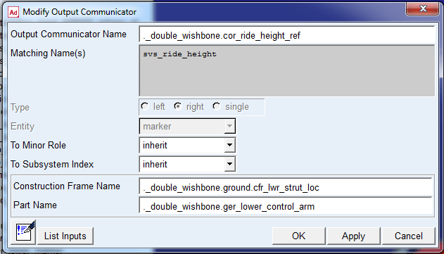

At this point while trying to learn/understand how this SVC ride height thingy works and to be able to modify it to suit my needs (I want it to measure Dz from user defined chassis points to ground) but I'm lost.
I found this request
I think that I found it on template level (_double_wishbone.tpl)
At this point I wanted to look at __MDI__SDI_TESTRIG to see what’s inside of it. Funny thing is that I just can’t find it databases. Do you know where it is located?
I understand that anything is possible. I also understand that this is a bit too much to ask but I will give it a try.
Is this possible to do it (modifying SVC so it shows FR/FL/RL/RR ride heights at my own chassis locations)?
I would guess that for this I have to:
1.Create markers at desired chassis locations.
2. Create Output Communicator on chassis template. Similar to 2nd screenshot.
3. Modify request .__MDI_SDI_TESTRIG.corner_heights so that it uses my markers.
Problem is that to be on the safe side I would like to keep original __MDI_SDI_Testrig unchanged and substitute it with my own version.
Also I can’t figure out which file is representing SVC procedure and where to find it. Looking in A/car database didn’t help. I wanted to look at the file to see what’s inside and if I can edit it.
I did manage to create my own requests measuring distance from ground origo to my chassis points and I can plot them after simulation but I wanted to have it included in SVC if at all possible.

MDI TEST RIG seems to be hidden somewhere, there's no file of that name.
I see no reason to mess with the testrig template to do that, you can just as easily (ha) modify your instrumentation template, I think.
There's a whole bunch of requests called things like adams_view_name='testrig.svc_output_2' which may be what it uses in the reports.
I can't find where svc is defined, I know where it is in /Chassis but /Car uses a different file structure. In chassis it is a python file.
