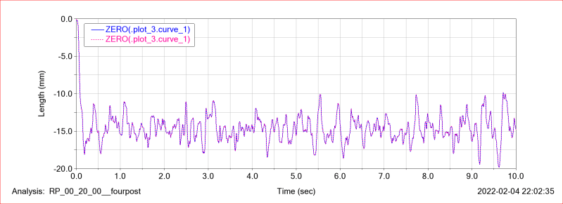

Found a solution to overlay two FFT curves on the same plot:
From A/Car help
Notes:
To overlay two FFT curves on the same plot:
1.
Use the FFT dialog box to create one FFT curve.
2.
Use the Offset tool on the Curve Edit toolbar to create a second curve. See Performing Simple Mathematical Calculations on Curve Data.
3.
Select the second curve and edit the expression for the curve using the Math option in the dashboard as explained in Using Expressions to Modify Curve Data Points.
I'm not using Adams postprocessor but I thought that someone that will read this may be interested.

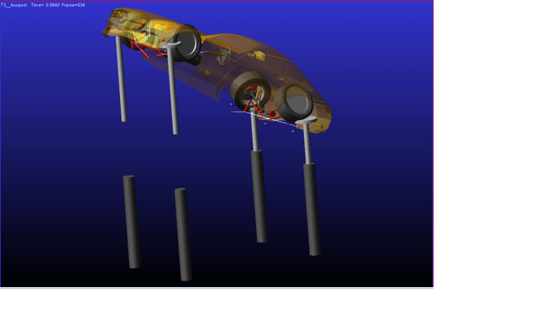

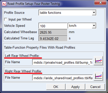

1.It seems that there's some problem with 4post test rig when trying to use table functions as road profiles. I actually starts with dialog box itself. When I choose table functions as profile source, instead of Left Wheeltrack profile (as per Acar help - "6. For the Left-Wheeltrack Profile, right-click the File Name text box, and then search the <aride_shared> database for the file bump_1inch.rpt." ) it is Left Rear Wheel profile (same for the right side):
May be it is some sort of typo...
Anyway, when I use example files flat.rpt (right side) and bump_1ich.rpt (left side) and run the analysis the rig would launch the car in the stratosphere.
If I use flat.rpt under both sides - same weird thing happens. I'm curious if that's me doing something wrong or that's the case of software bug? Using RPC file based road profiles works without problems.

1 - I don't know I haven't used 4poster in Car. An interesting thought is that a test we currently do for which I have a large slab of custom adm won't work in Car. yes it was probably a typo.

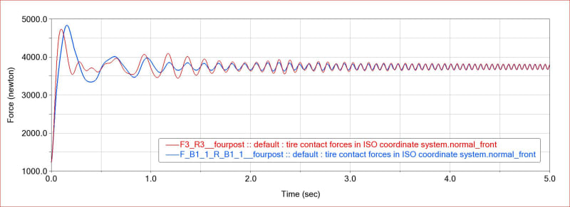

Problem is that with Pitch and CPL it is not as straight forward.
CPL - on the plot is is visibly clear that F_B1_1_R_B1_1 (starting from ~ 0.8sec) force variation is lower then F3_3 plot, yet standard deviation of F_B1_1_R_B1_1 = 254.4 , for 3_3 = 231.95. There's similar problem with Pitch angle.
Is there a proper way to use Adams insight for Design Objectives such as CPL?

Hmmm... I'm not sure I fully understand you. What is Vpp/2.8?
Still the main question is how do I go about using CPL as Design Objective for Adams insight...Is it feasible to use standard deviation during simulation value?
Thank you,
Ted
Vpp = peak to peak amplitude, which look to be around 160 in your plot. Yes, there is no reason in principle why you can't use standard deviation as a response, but as I said, I don't think it is measuring what you think it is. Perhaps it is taking SD of the whole sample, which would be very messy in the case of something with a large DC offset, even if detrended. If I don't like the way Insight is calculating something I export the workspace, substitute the values I want, and then reimport the workspace.

Yes,those numbers that I posted were calculated in excel using all sample. I think that the moment when ADAMS "drops" the car on the rig creates that "problem". I assume that there's no way to set up request so that it outputs data starting from some prescribed moment in time?
Thank you,
Ted
Don't use those yet but I guess that there's no way around learning to use Matlab - it seem to be an essential tool. So I would guess that till I get familiar with Matlab there's no way to answer my question.
Anyway I can do it (process a desired portion of data) in other software - even simple excel.
Let me ask in a more general way... Say I have to arrays of Tire normal load data. My objective is to find a way to get some sort of sufficient way to get some sort of statistical value that would allow me to judge if one data set is "better"
or "worse" and that's what I struggle with atm.

Yes for the time being calculating in Excel and filling the workspace in by hand is a reasonable solution, BTDT.
I have never defined a custom response in Insight, I know it is possible. RMS of a detrended sinusoid seems like a good way of describing it, or you could use kurtosis which is 4th power moment and so is more sensitive to peaks. Either are very sensitive to DC offsets, and long term drifts, and detrending is a great way of screwing things up. Ideally I'd high pass filter the signal before taking the rms, or do it all in the frequency domain.
