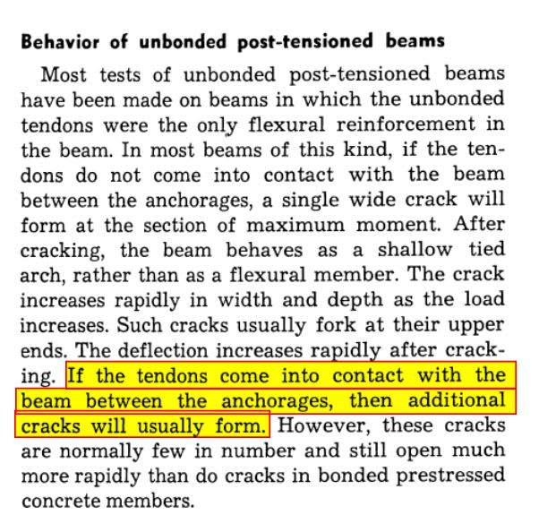

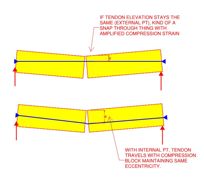

It seems to me that rapt is suggesting more than mere semantic confusion about definitions. I believe he is suggesting that, without As.min, a huge crack could open up at the maximum moment, say midspan, which could not be prevented by the unbonded tendons. A large angle change could occur at midspan, causing concrete strains to increase to the point of failure. If Mattock relied on tests showing this to be the case, I have nothing to add, having not seen the tests. Suffice it to say, it is not what I would have expected.
A large angle change at midspan should have no effect on tendon strength, so that should not be a factor.
The probability of anchorage failure is small but non-zero. That is one good argument against the use of unbonded PT systems, but the provision of As.min does not help that problem.

Thanks Rapt. I have Leonhardt, at your previous recommendation, and thought my collection complete. Now I must have Guyon! They're pricy though so I want to make sure that I get the best one. Looking at the table of contents for the 1953, it seemed focused on elastic behavior and I wondered if the 1974 (Limit States) might include more plastic design concepts. I don't need easy; I want as deep a technical treatment as I can get my hand on.
Interesting. Some thoughts on that below, including the interesting statement in the Mattock article that performance improves when the tendon is made to come in contact with the concrete.
Kootk,
Yes it would improve at low levels of load with draped tendons but not a lot. But the final failure/collapse condition is the problem.
