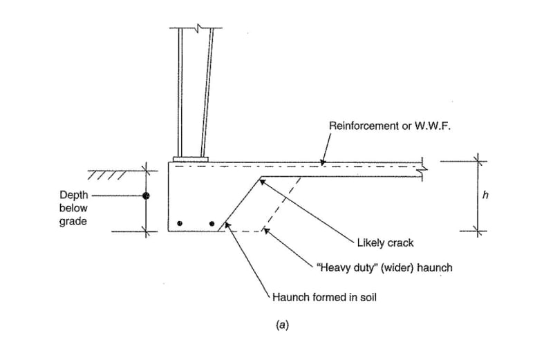

The two options for the type of foundation to use for the condition described original post is a "Downturn slab/slab with haunch" or a Mat Foundation (slan-on-grade w/drilled piers or spread footings are out of the question).

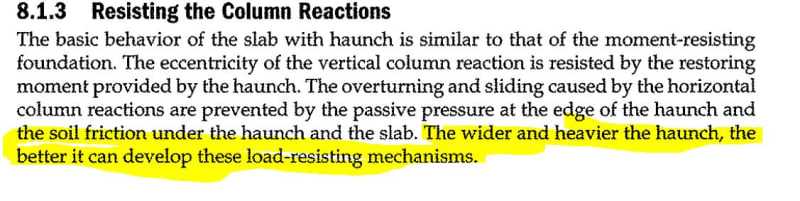

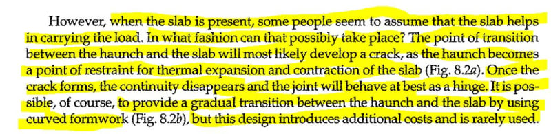

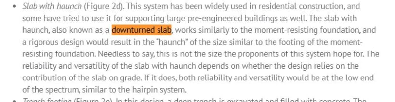

The more I look into my two options, it appears that the "Downturn slab/slab with haunch" is not recommended. Please read the image below:

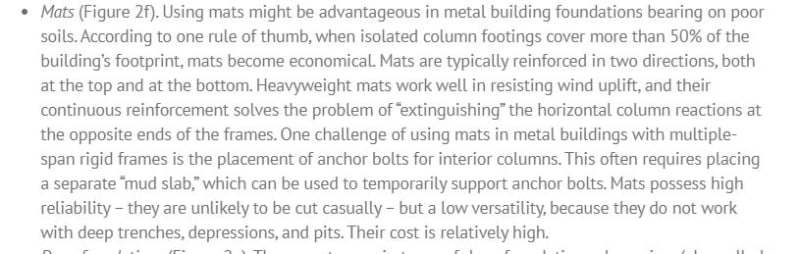

It appears that the mat foundation can be costly, but more functional. It seems like a mat foundation can be more economical compared to a Downturn slab depending on the siutation. Please see image below:

The Foundation and Anchor Design Guide for Metal Building Systems book has a procedure to design the downturn slab fdn. I will run the numbers to determine if the downturn slab is more economical than the mat fdn.

Here is an example picture of a potential downturn slab detail:
Once I run the calculations, I can determine how long and thick my haunch will be. My foot print is rather large, so the downturn slab may look like an economical option at 1st, but it may be more labor intensive for a 84 ft by 38 ft area. In that case, the mat foundation would be, in my opinion, easier/quicker & cheaper to build. Due to the anchorage of the equipment skid, I expect my slab to be thicker than 12".
It appears that I am able to make a downturn slab work with the applied loads I have generated based o the wind speed for the area of the project.

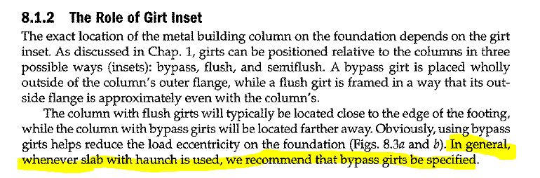

I am still concerned with the use of the downturn slab for the pre-engineered & equipment skid foundation. The Foundation and Anchor Design Guide for Metal Building Systems says the following:
Based on what the image above says, it seems that the slab with haunch foundation should not be used for a pre-engineered canopy. I wouldn't think that a pre-engineered canopy would have girt inset.
I'm reading that the other way. When you have the bypass condition, which you may well, the slab haunch is okay.
