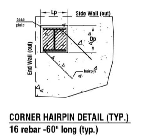

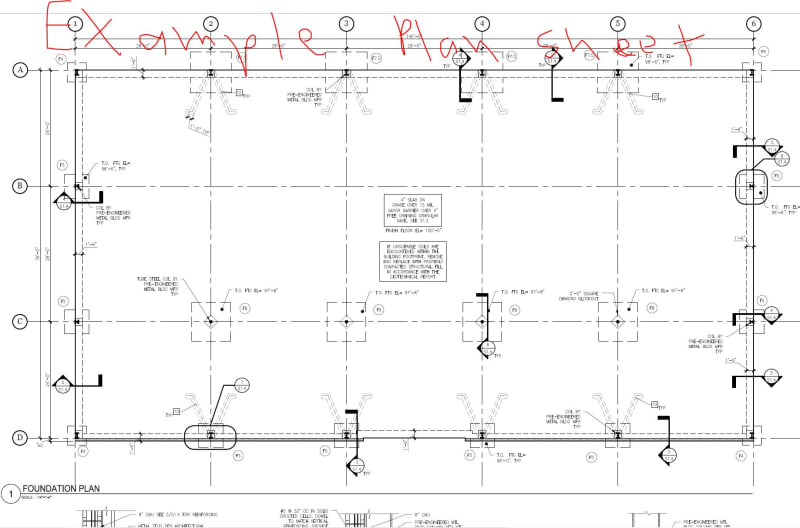

Question: Are hairpins at the corner columns necessary? I ask because I have come across plans that do not show them in the slab (see image below).
If they are necessary, what is the best practice to detail them on construction documents?
What would be the reason for not having hairpins at the corner columns? What would be the reason for having hairpins at the corner columns?
Would this detail work (see image below)?
Often the end walls have intermittent wind posts that support the beams such that large amounts of corner column base thrust are not developed. Additionally, if appreciable base thrusts do develop, it is often possible to transfer those loads into the perimeter downturn / grade beam.
Okay, thank you for mentioning the wind posts. My pre-engineered canopy will be open all around, so I do not foresee there being any wind posts attached to the canopy.
So, it seems that hairpins at the corner columns would be advantages to use in my specific situation.
Would you happen to know the best practice for detailing the hairpins at corner columns?
Would the detail I show in the previous post be best practice?
As I mentioned in my last post, why not resist the thrust with bars in the downturn / grade beam? If you go with slab hairpins, I'd go with a pair of them oriented orthogonally and enclosing all of the anchor bolts.
In the example plan above, it seems there is grade beam along each edge, which is capable of acting as tension tie, so the corner column is well confined, and the lateral movement is prevented by the reinforcement in the grade beams. for unreinforced SOG, you do need to check concrete strength around the column, and provide hairpin as shown on the sketch.

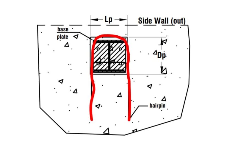

Would this detail, in the image below, be structurally acceptable as well? I am thinking this because I believe that this is the direction the force would travel in to the hairpin.
Yes. It is acceptable.
