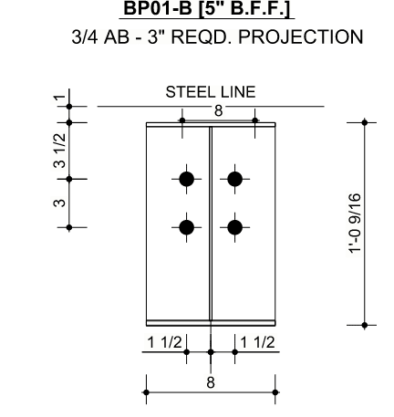

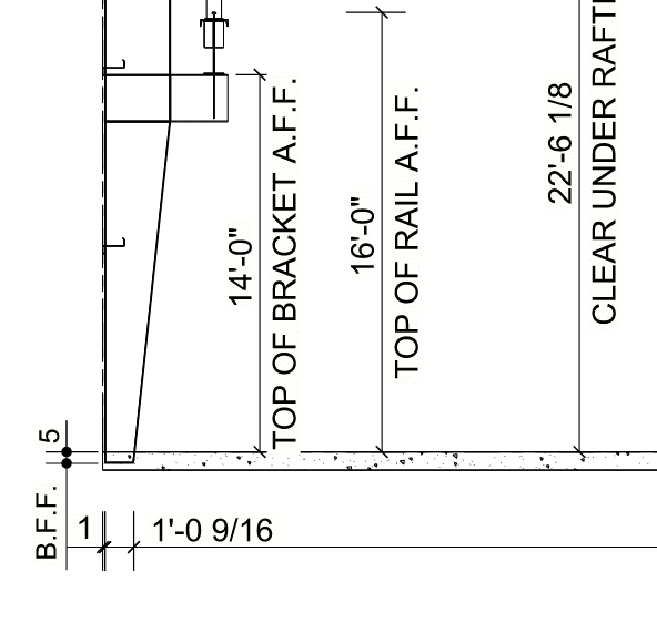

I am designing the foundations for a PEMB where the bottom of baseplate is 5" below the finished concrete floor. Normally I use the hairpin method to transfer the horizontal forces into the slab on grade. But I cannot do that now that the baseplate is lower than the top of slab. What is the next best option? Moment-resisting foundations?
Has anyone ever seen this before where the bottom of base plate is below the slab elevation?
You might weld rebar couplers onto the column and thread dowels into those that project into the slab. I do preferer moment resisting footings but those can be a tough sell.
Can you post some basic details so we can see the arrangement? For instance, is the column tight to the edge of the slab, or will you have bypass girts and another 8" of slab outside of the column flange? If you have room, you could still put in hairpins around the whole column to drag the lateral thrust back into the slab. If you don't, then I'd put a tension tie below the slab. It will be continuous bars that go from one set of anchors on one side of the building to the anchors on the other and will be encased in concrete.

Here are some details from the PEMB drawings...
I think the edge of slab wants to be at the steel line (which is 1" off of the outside face of baseplate).

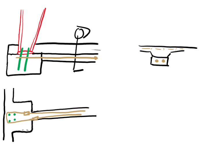

Back to the matter at hand...I'd do this:
Would something like this work?
If you design it as a non-contact lap splice you might be able to, but you'd be better off with a few more yards of concrete (once you get into the strut and tie discussion with KootK on how a non-contact lap splice works you'll understand why). But considering there's a cold joint in there it's unlikely.
Any reason you don't want to put a dedicated tension member beneath the slab? If it's an aversion to doing something "different" you can forget about it. That ship sailed when you wound up with PEMB base plates below TOS. It's not new, but it isn't SOP. So that means your solution probably can't be SOP either.

Ben - you have a 4' retaining wall, so you have a continuous footing that's either capable of resisting the moment or is tied into the slab. With some careful detailing you may be able to use that to your advantage. Increase the slab/wall connection capacity on either side of your column for a reasonable distance and detail a load path for the load to go from the base of the column, into the wall, and back up into the slab and across to the opposing load on the other side. Or increase the footing width at the pedestal if you have it designed as an unrestrained wall with a floating slab.
