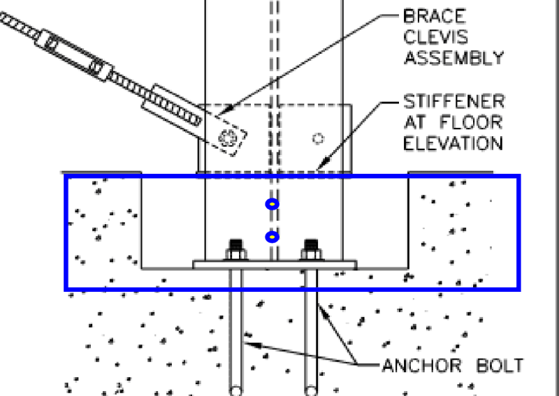

I am designing the foundations for a PEMB where the bottom of baseplate is 5" below the finished concrete floor. Normally I use the hairpin method to transfer the horizontal forces into the slab on grade. But I cannot do that now that the baseplate is lower than the top of slab. What is the next best option? Moment-resisting foundations?
Has anyone ever seen this before where the bottom of base plate is below the slab elevation?

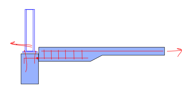

In a similar vein, I wonder if a partial cross tie might be an attractive in some situations. I could get behind that. The far end wants to rotate down into the earth anyhow.

I like your partial cross tie from a technical perspective, but I'm not sure I'd want to be the salesman.
Pros:
Eliminates the tie beam below the slab which many see as different and, therefore, frightening.
Reduces material usage for large buildings
Cons:
It's still different and, therefore, still frightening.
The design is slightly more complicated
The implementation involves more pieces that have to be fabricated
Removes some resiliency as compared to the tie beam - as Gopher mentioned somebody is likely to cut a trench to put a toilet in there eventually. The effect is worse for larger buildings where those tension loads get real.

Pish-posh. Just a little rebar that was likely to be there in the form of hairpins initially anyhow. I'd even be willing to omit the ties if the bar offset was <= 6"
That kind of depends on how you look at it. If you put all of your eggs in one basket with a tie beam, someone might come along and chop that anyhow if they really need a toilet. If we used my partial ties to get the load out into the SOG convincingly to begin with, then there would likely be plenty of possible load paths for the tie force in a 6" slab to go around a toilet. You know, unless somebody comes and installs a big, building wide trench perpendicular to the ties. There's only so much hand holding one can do of course.
One thing that I like about my partial tie stirrups is that, hopefully, those would trigger some thinking when encountered during a renovation.
Naturally, a tie that is integral will the SOG can be the best of both worlds potentially. When I've done discrete ties, they've actually been separate from the SOG so as not to mess with shrinkage cracking, joint layouts etc.
It really is a shame the rebar couplers are out for warranty/liability reason. It would have been a gloriously direct load path otherwise. And you'd have a tough time convincing me that it would do any real harm to the PEMB columns.

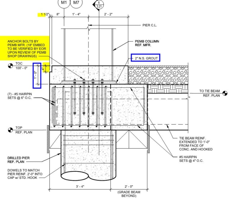

Here's how a building I'm working on has handled the below grade PEMB column.
With regard to tie beams of all sorts, I believe that ACI has some special requirements:
1) No lap spicing. It's gotta be mechanical, weld, strut and tie, etc.
2) More onerous crack control. And this is good as it keeps us from designing the ties to As x fy and having them stretch out like big rubber bands.
#1 implies that my solution would have to include the ties however.
I called the PEMB designer and asked him what was up with the baseplate being -5" below top of slab. He said that the owner wanted to have a smooth slab. I asked him if raising the baseplate to the top of slab would change anything with his design. He said no and condescendingly explained to me why this wouldn't change his design. But I digress...
My next call is to the architect. Mr. Architect, can you please explain to your client that lowering the baseplate is going to cost him more money due to x, y, z.
30 minutes later, the client makes the decision to move the baseplate to the top of slab.
Welcome back to your regularly scheduled program.
