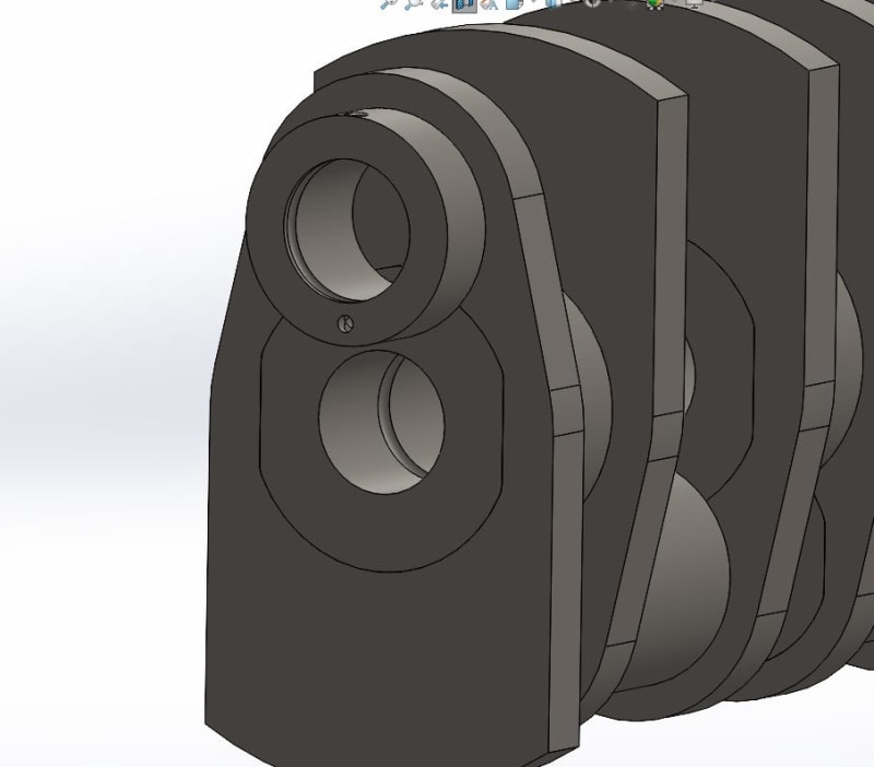

I'm designing a V8 engine, mainly for the challenge, and I've been trying to decide on either a conventional billet crankshaft or a press-together one. I have no doubts that the plain billet crank would work just fine, but I don't want to discount the advantages of a press-together type as it makes the machining to get the rotation mass down a bit easier. I thought that with the very accurate tolerances available with good EDM gear, I could make the connecting surfaces have shapes that aren't the typical round profile that's locked together with a spot of weld, but, for example, have a round section that has two parallel sides on it. That would lock the various parts together quite accurately & firmly.
I was also wondering about the strength of such a PTG crank, as it wouldn't have the stress areas around the journals like a regular crank would.
So, any thoughts or suggestions please?
Note that I haven't calculated the counterweight masses & sizes, so the pictured cranks are just as an example.

I'm not sure how you're not getting this - The areas where they join wouldn't be round the entire way around, they'd have a couple of parallel sides to the parts can only go together one way and with perfect accuracy.
You can't see it very clearly in the screen captures above, but I have a way of taking quite a lot of weight out of the crank.
Here's a view with a little bit of the crank cut off so you can see the main journal a bit better. Note the parallel sides on the pin. It can only go in one way (unless you fit it 180º out!) and so quite accurate.
That won't result in a uniform press fit, but if you are going for EDM you can get a much closer approximation using a version of the Torx form to avoid a stress concentration in the corner and the continuously varying force along the flats.
Interesting idea. Honestly, my opinion depends on your goal. If this came across my desk at work I would say that it needlessly complicates production and results in a weaker crank. As a hobby challenge tho, sure, it could work and run. I have quite a few friends among the model-engineering hobby crowd and this is pretty normal compared to many of their ideas.

Something (well... your posts) tell me you haven't done any stress evaluation yet, or put any thought into that aspect of your design.
Your interfaces must be press fit. It's not optional. If they aren't, the clearance of even the finest slip fit will result in relative movement between parts; crankshaft loads are reversing loads. Any relative movement at all will result in catastrophic part failures, and they will happen quickly. At 10,000 RPM, any part of an engine reaches millions of load cycles in a matter of hours.
If you have to have press fits (which you do) that also means your mating parts, both male and female, need enough material to handle their service loads plus whatever additional load results from the press fits at assembly. These loads never go away - after all they need to be there to keep your parts together.
This means that building a crank that's pressed together and as light as one that is made from billet is not possible. Note above the list of applications that use press fit cranks; none of them use a press fit crank because its stronger or lighter. They use it because some other condition makes a single piece crank impossible.
In short, your press fit crank assembly is going to be more expensive, heavier, and less strong than a billet crank of the same material.
If your goal is maximum performance, minimum cost, or both, just use billet. The only reason to do it the way you're describing would be for its own sake. If that's what your goal is, well, fine. But it won't be 'better' in any conceivable way.

No I did get it, I'm just trying to discuss the alternative to the typical method of connecting the various parts of a press-together crank, by having high precision mounting surfaces made by EDM gear, with the intent that it both perfectly aligns the two parts and also locks them together to eliminate the possibility of the two losing alignment.
The loss of alignment seems to be the main problem with PT cranks, and for the reasons mentioned previously.
I do consider your mention of the stresses caused by the interference fit between the various parts, but the degree of interference could be reduced because of the interlocking shape of the two parts. Further up a chap mentioned that a Torx-type joint between the two parts would probably be better and I think he's correct. But I don't think it'd be needed all the way around, just three or four bumps/dips to lock the alignment between them. I can draw up a diagram to make that clearer if you like.
In any case I'm certainly not determined to go down the PT crank path, it's just something I want to have a good look at before either using it or not. The reduced oil requirement for a PT crank with roller bearings is very tempting. I know a plain old billet crank would work just fine, but I want to do the best job I can, not one that's merely okay. ;)

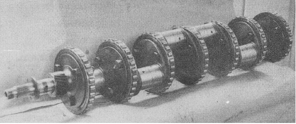

For a stronger, easier to machine, and much more compact crankshaft, consider the disc-web crankshaft where the webs are the main bearings. There have been both roller bearing versions and plain bearing versions of this style crank in the past. In the case of the plain bearing version shown here, the crank was a hollow iron casting. This style crank requires a tunnel crankcase.
[URL unfurl="true"]https://res.cloudinary.com/engineering-com/image/upload/v1681251144/tips/Tatra_Disc-Web_Crank_rxtxe6.bmp[/url][URL unfurl="true"]https://res.cloudinary.com/engineering-com/image/upload/v1681251171/tips/Gleniffer_DHV8_Crank_wpcwor.tiff[/url]
