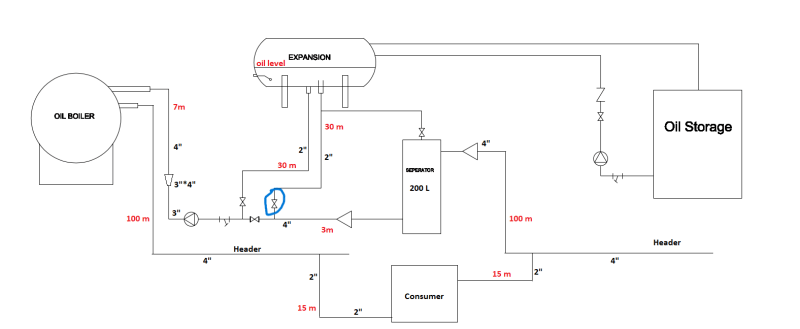

Hello everyone,
I'm facing an issue with a hot oil circulation system used to heat the jackets of some mixers. The system operates as a closed circulation loop with a centrifugal pump. Initially, the pressure at the boiler's inlet is 10.5 bar, which aligns with both the system curve from simulations and the pump curve (100 m3/hr). However, after approximately 1 minute, the pressure begins to drop from 10 to around 3 bars in 2 minutes, accompanied by noticeable noise in the pump case, probably indicative of cavitation. The system has an expansion tank and we always have the NPSHr (around 1.3 bar) in the suction.
We're using flow control valves for each consumer, and currently, only one consumer is in operation. when we introduce the second consumer, the pressure drop accelerates further. The pressure at the consumer outlet is 5.5 bar at the beginning of the circulation.
Any suggestions or advice would be greatly appreciated. Please let me know if you need any further information.
Thank you

What is this mysterious "separator" on the pump suction line - what does it do? And why isnt the top line out from this separator connected to the TOP of the expansion drum ? This separator should be as tall as the top of the expansion drum?
When you say oil boiler, you mean hot oil heater?
Can we see a detailed PID of this expansion drum that shows the installation of this level switch? Do you have any other level device to confirm what the "level switch " is telling you ? When you say level switch, you mean level transmitter? What else can you tell us about this level switch ?
Your PFD does not show a pump min flow recycle which should go from oil heater exit back to pump suction. This would also function as a heater min flow line. Without it, oil will coke up in the heater at low consumer demand. What is the stated max possible turndown on the oil heater duty - is it 5:1 or better ?

Regarding the minimum flow line, I am trying to make one between discharge and suction of the pump to control the flow rate into the headers but I don't know if it will work or not. do you have any advice on that?
Note that pumps do not create pressure. They impart energy to the liquid and the pressure comes from the friction of the fluid flowing through the system. Although I doubt that you are running off the right hand side of the curve you should verify that. The easiest way to do this is to read the current (amps) being drawn by the pump motor. If the pump is too big and the friction through the delivery piping is too small then you will run off the curve and you will see that from the actual amps being close to the maximum. You don't even need the pump curve to do this check. The motor nameplate will give the maximum current.
At the moment you do not know whether the problem is on the delivery or suction side of the pump. This quick test will give you a good idea very easily and then you can start homing in on the real location of the problem.

Min flow line should be located on discharge of oil heater, so that it acts as min flow protection for both pump and heater. The exit from min flow recycle should be to hot oil return header.
Mixer side pressure is higher than hot oil at mixer ? Have you checked for pressure integrity of hot oil tubing within each mixer, if the mixer product can leak into thin wall hot oil tubes through tube ruptures?
Pump suction strainer blocked ?
That top line from the separator should be connected to the top of the expansion drum.
We dont use these float switches these days - use a dp cell which is remote sealed on its impulse lines.
Try operating with the top exit line from this " separator" closed. You may be somehow pulling in gas from the expansion drum into the separator.

1) your "boiler " or heater. what type of heater matrix is this?
Does the inlet go in at the top as shown or was that just a schematic
2) you say the equipment is a "jacket" Again what type of jacket? Is the inlet at the bottom or the top and where is the exit.
3) You say inlet pressure to boiler is 10.5 bar and pressure at the consumer Outlet is 5.5 barg? Do you have any other pressure gauges.
This looks to m then like you have somewhere between 3 and 4 bar differential pressure for about 100m of 4" pipe, though the 15 lengths of 2" pipe might generate a lot of friction equal to the 4" length. Anyway this sort of pressure drop for that length of pipe is very high.
4) I'm failing to understand how you managed to buy a boiler/heater package at no doubt considerable expense and yet seem to have no idea what exactly you ordered or indeed what you bought.?? There surely must be something more than this (even if it's just written on the order!), though I agree that nameplate on the motor is scandalous in its lack of information that simply wouldn't be allowed in most countries.
5) Just because the pressure is approx. 100m differential doesn't mean you're doing 100m3/hr. The curve is pretty flat and as you don't know what size impellor is in there you could be doing anywhere from 20 to 200 m3/hr and the pressure would be pretty much the same.
6) The key missing data is any sort of flow measurement. I'm not sure why when you add another consumer you don't simply close the first control valve some more to reduce overall flow or at least keep it the same.
7) Without more data you won't fix this and it certainly looks like something is very badly mis matched or there is still a load of air in the system or it keeps getting introduced somehow. Is there a more comprehensive P&ID?

The PFD shows the 2nd liquid exit leg from the expansion drum has an internal standpipe in the drum. If the normal liquid level maintained by this crude float switch is below say,50-80mm above the top of this standpipe, then it could be drawing in gas from the drum into pump suction. So close both the top exit line from this separator AND the valve on this 2nd liquid leg on the drum ( valve circled blue in this posted PFD ).

In the document attached no separator. statement about cavitation
the link above is explaining the position of the valves for degassing. Please review your PFD accordingly.
Note: There is also a comment about the pipe size . My understanding is the 2" pipes should be 4", similar to the return header pipe.

The uprise of the first outlet of the expansion tank is around 15 cm and we have a level of 70 cm in the expansion tank. I thought that it could cause no problem but I will check again the system with that valve closed. Thanks for the advice.

HI Eric - I think that with this latest info we are zeroing in on the location of the problem. But even if we can work out where the problem is I am at a loss to work out what it could be. The elevations you have and the fact that the flow through the mixer jackets is upwards eliminates the 2 phase flow suspicions I had.
At start up the pressure after the consumer was 5.5 bar and after about 2 minutes it dropped to 1.7 bar. This already sounds dramatic enough, but when we consider that there is 1.5 bar of static head we see that the friction head drops from 4.0 bar (=5.5-1.5) to 0.2 bar (=1.7-1.5).
There has to be something very wrong/strange in the piping between the consumer and the separator that causes the friction loss to decrease by 95% despite an increase in the flow rate. This will require very careful inspection on site and there's not much we can help with while sitting behind our computers.
If there is nothing changing in the friction after the consumer then the drop in pressure can only be caused by a decrease in flow. Is there perhaps an over-pressure protection valve somewhere (that is not shown on the flow diagram) that could be opening slowly and reducing the flow though the circuit while increasing the flow through the pump (and resulting in the increased power draw)?
