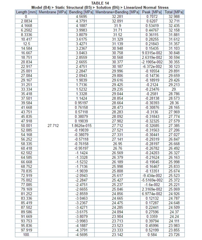

I am completing an FEA analysis to support an ASME VIII Div.1 vessel by completing the analysis to ASME VIII Div.2.
I have attached screenshots that show my 1/4 model and also the location of my SCL (The highlighted line in the centre of the three)
I have also attached the results file stating the six component stresses at each node's location along the SCL.
Would either of you be able to enlighten me as to how to proceed to calculate the Membrane Stress & Membrane + Bending Stress?

OK TGS4, I think that I understood.
I corrected my calculation consider the lenght (dx).
but I can't find the bending stresses along the path, like ansys show at table.

I would ignore the intermediate points. They are merely points along a straight line. The intermediate points are not calculated by anything other than y=mx+b. Figure out how to do the linearization first.
TGS4,
I corrected my calculation, and the values are equal to Ansys, I calculated with the following:
Sm=((Σ1n-1(Sij)+ Sij[0]/2 + Sij[n]/2)/n
Sb=[(Σ1n-1(Sij*(t/2 - X)/t)+ (Sij[0]*(t/2 - X[0])/t)/2 + (Sij[n]*(t/2 - X[n])/t)/2]/n
But I'm confused if the bending calculation is according to ASME VIII Div.2 formula (5-A.2) and described in 5-A.4.1.2(c)

Now that you have figured out how to properly linearize a through-thickness stress distribution, there are a couple of more things. First, you have now calculated the linearizations of the component stresses, which need to be rounded up into an invariant (such as von Mises, if you are using the latest Edition of VIII-2). To do so, please pay special attention to my post of 2 Aug 16 16:12. How ANSYS calculated the bending invariant is WRONG when it comes to compliance with Annex 5-A (I've only been fighting with ANSYS for 17 years to fix it, but that's another story).
Furthermore, I am going to ask a much more fundamental question. You say that you are doing this for a graduate thesis. My impression of university graduate-level work is that it should be relatively on the cutting-edge of technology. Why, then, are you using a technology (linear-elastic stress analysis using stress linearization/categorization for demonstrating either Protection Against Plastic Collapse or Protection Against Failure From Cyclic Loading: Ratcheting) that is 50 years old, when a perfectly good modern technology (elastic-plastic stress analysis) that doesn't suffer from the same complications and constraints exists?

For your second advice, I answer: I will upgrade my studies to a elastic-plastic stress analasys of course, but first I wanna understand the beginning.
Thank you again.
At last, other question:
About the peak stress (Sp), Is the calculation below correct?
Sp0=Sij0 - (Sm+Sb)
Spt=Sijt - (Sm-Sb)
(I thought very simple)
Yes. The peak stress is the value of the actual stress subtracted from the membrane plus/minus bending.
