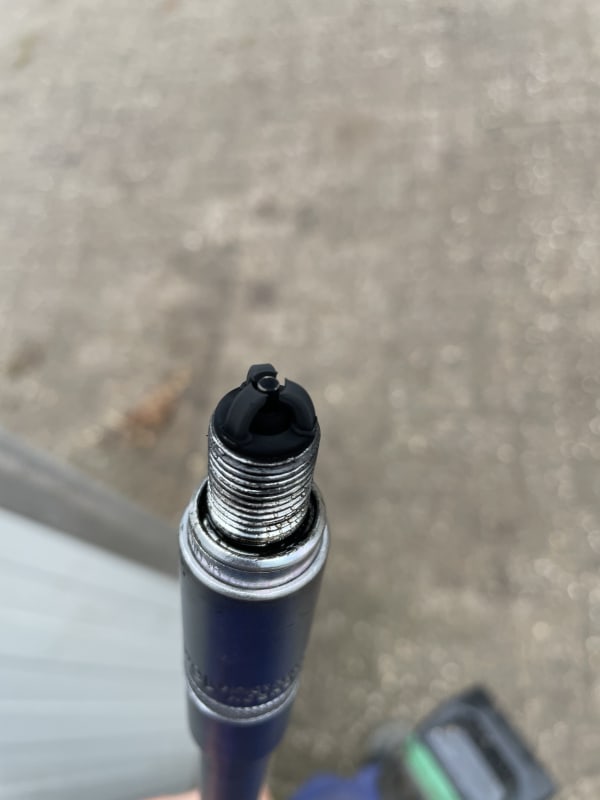

So what to do now? This is how the sparkplugs look from the running cilinders
What do you think about it? It is a new sparkplug
Have you checked the battery and alternator outputs? It is not unusual to have a misfire from low voltage.
My ol' smoky riding mower fouled plugs with carbon just like that every 4-6 hours. It would run great for a month then refuse to start, so I'd pull the plug and use a dental pick to clean it out, wire brush, reinstall, and run it another 4-6. It had a vertical crank/horizontal cylinder, snd was about as cheaply built as possible so I didn't bother trying to repair or even be upset when the connecting rod broke ~600 hours.
JMO but I suspect you have an oil control issue, maybe stem seals, rings, or bottom end damage.
Black like that could be bad oil control or way rich. It could be that the whole engine is on the verge of rich misfire, but the one cylinder due to inherent variations is too rich to fire under some conditions. Why it's way rich, and what to do about it, is the next challenge.
Probably way-rich.
Does it blow black smoke or blue? Black = rich, blue = oil. (and don't say neither - I won't believe you)

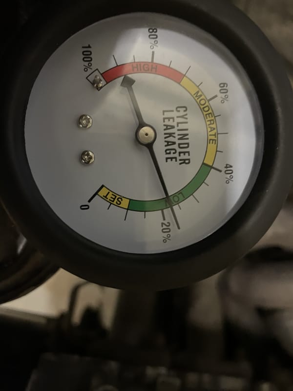

So I did a leak down test to check the rings. Looks good
