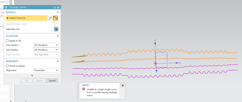

i have tried to do this "through curves" but still got something wrong. You may find the warning in this picture. Maybe the contour lines are too complicated to do this operation?
You have selected two separate curves as if they where the same section,
select 1, then click the "add new set" button, ( or shortcut : click the middle mouse button)
you need in this case select the four splines as four "sections".
NX will create the surface " from section 1 to section 2 to section n", and if you tick the "closed in V" it will close from section "n" to section 1.

@Toost thank you four your help
really appreciate it and your advice really works.
