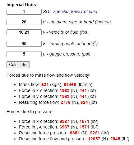

I'm partway there now. My 10,000gpm on a 20" pipe results in a velocity of 10.21 feet per sec.
Do I have enough info to determine how much pressure would be left after the lift though? I'm thinking that nets out to zero; or near zero.
Using one of the online helpers, with my velocity (10.21 fps) and IF I'm down to 5psi; then I'm only dealing with a 2.85 kip thrust force on a 90-degree turn. I might be able to work with that.
Looks about right. 50 Hp will only lift to the 17 TDH, with the LWL where it is, that's 4ft over the discharge centerline. I only get a couple of psi pressure.
