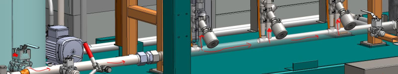

We are running a system with 3 positive gear pumps in parallel that installed at the outlet of a tank, like the picture below:
The left pump is the closest pump to the tank.
The outlet of the tank is 1.5", going up to suction of the pump is 3/4" for each pump and the discharge pipe is 1/2".
On each pipe coming out of the pump we installed an very accurate mass flow meter.
We are facing an issue when we are working in 2 or 3 pumps. when running a single pump the flow is stable.
When working with two pumps, the pump that closer to the tank having fluctuations in flow, while the pump that is further away has a very stable flow.
When we are working with 3 pumps, the pump that closest to the tank has fluctuations and the other 2 are very stable.
The flow is the same in one/two or three pumps.
I would be happy for your opinion on the subject, I assume that the reason is losses in head suction, but from calculations I have made there should be no problems.
Thanks in advance.

Hey all,
Here is a picture of the design of the system:
The connection to the lines going up to the pump is welded, the tees you can see behind is just for flushing.
I guess and as you say, we have an issue that can cause a cavitation, maybe because of to much losses in the pipes.
But my question is why if I'm working with one pump at 10 LPM I get a stable flow, and if I'm working with 5 LPM at 2 pumps in parallel I got an unstable one line and the other is stable.
I don't understand why, if the total flow is the same so the losses in piping and vapor pressure is also the same.

A bit confusing - is that flushing tee a separate pipe? - I'll assume it is.
These make it look like the smaller branch pipe is just stabbed directly into the header?
They can be quite brutal as often the fitter just cuts the branch pipe at 90 degrees and inserts the pipe into the header and then fillet welds it. It is sometimes difficult to know how much pipe is sticking into the header pipe. The only way to find out is to cut the thing and look... sometimes the branch pipe extends in more than 50% of the diameter of the header pipe.
The issue I think you're getting is that when only one pump is flowing then the fluid flow can adjust for this sudden sharp edged 90 degree change in direction, but when the flow is going past it to the next pump you're getting a venturi like effect as the flow disrupts the flow into the first pipe, creating low pressure pockets and hence boiling of the water.
If I was you I would just replace this section of pipe and use proper tees or weldolets if indeed the fabrication is as I described - an actual photo would help.... And make the header 2" and the branches 1". Or use 1.5" tees and then reduce down to 0.75".
