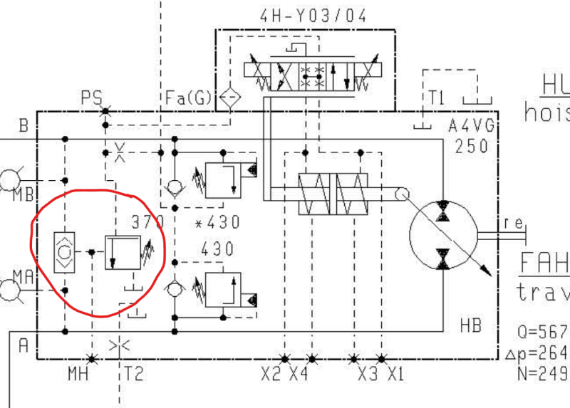

Here's your hot oil valve (and the answer to 73lafuite's question about where the hot oil goes). A worn hot-oil relief is quite a good way of losing charge pressure.
But then I'm not 100% convinced I'm looking at the same motor as you are - the component labelling on the drawing is a bit strange.

The normal leakage will exchange the oil. I would not design it like that, I would use a flushing valve but systems without flushingvalves do exist.
zeusfaber, the valve you encircled is not a flushing valve, it is the pressure cut off for the A4VG pump.

1) My remarks which do not help barbican: Totally agree with Jacc, the valve serves well to cancel the flow of the pump when the pressure is too high. Indeed I have already seen closed circuits without exchange valve (example lawn mower). But it is not serious. Any particles that are a little large will be laminated in the distribution glasses, the piston pads and will break up into millions of particles the size of several molecules to manage to come out with the internal leaks. And so as long as it's in the closed loop it scratches and tears off other particles. Liebherr should have put a nozzle and a normally closed 2/2 directional valve between the A of the engines and the tank. And supply the distributor when the load increases.
