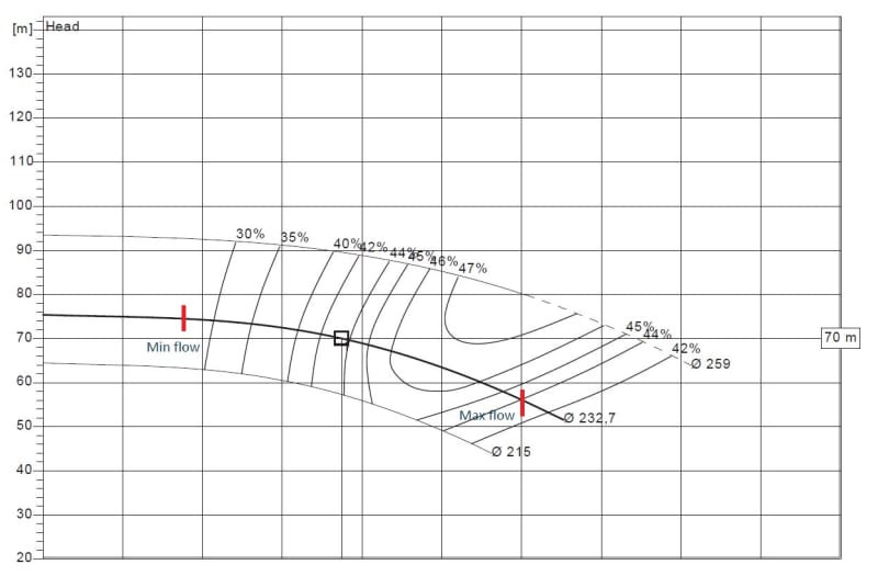

Well, to begin i'll answer as much as i can. First of all, the potable water network system is in a power plant. The drain that i'm talking about is whatever drain you open, for example even if you open an eyewash the pressure drops in the discharge and the suction sides. The pump trips of Low Low alarm suction pressure in 0.3bar. The suction pressure without any consumer open stays at 0.5 bar.
Furthermore you see the pump curve in the image below:
and the NPSH:

It looks like the pump is going to the end of the curve flow when any consumer is opened and additional flow is causing the pressure drop in the suction line. The same may be the case when pump is started with no pressure in the discharge header. Try operating the pump with throttled discharge valve and see whether there is any improvement.
