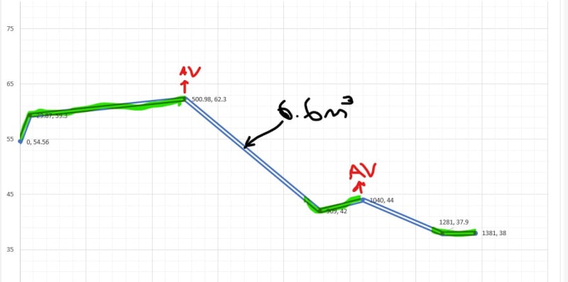

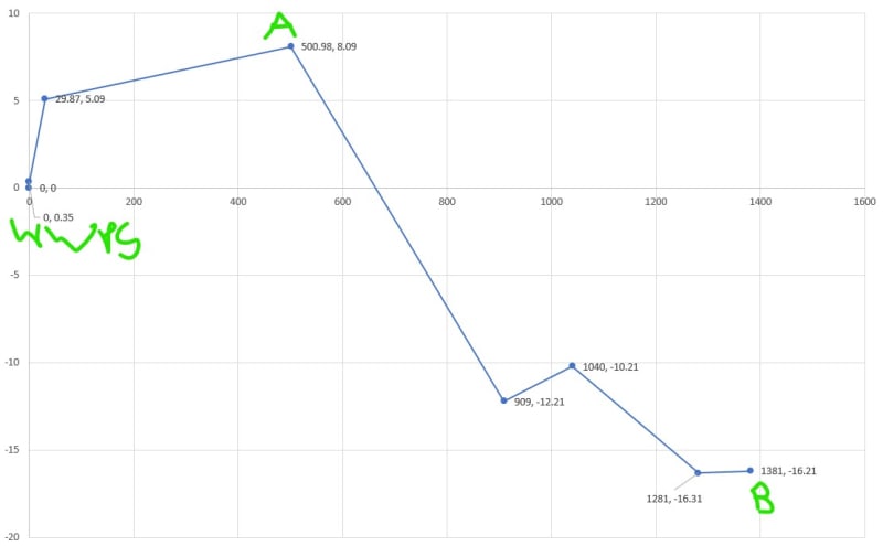

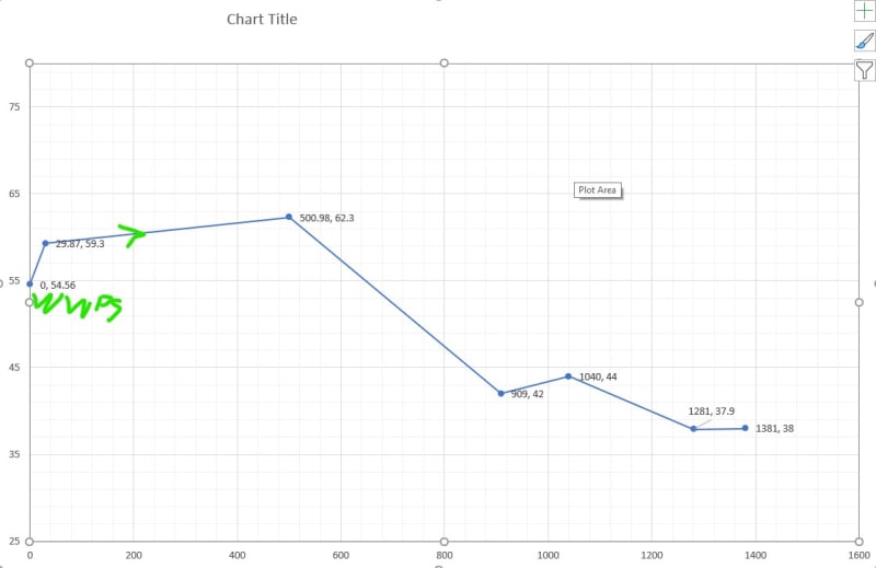

have attached 2 simplified long sections (Chainages and static head, and chainages and elevation)
Pipe diameter is 146mm ID PE pipe
Duty point for the pump is 27.86 l/s at 26.1m for the first crest (A) and 25.8 l/s at 26.6m for full length (B)

If the pipe length between points A and B is 1000 m and the difference in height is 24.3 m then the flow rate with the pipe full of water would be around 36.5 l/s (velocity = 2.2 m/s). Note that this assumes a vacuum breaker at point A, making the pressure in the line at Point A atmospheric.
If your flow rate is less than 36.5 l/s then the pipe will not run full. At 28 l/s only the last 120 m of the pipe down to the 909, 42 point will run full.

From your end point, draw a line back from your arrival head ( presumably near zero if you're emptying into a gravity manhole or something) at the hydraulic slope ( m/100m) you've calculated for the flowrate and pipe size.
If it hits the elevation of the ground before getting over the high point, then you're in slack flow or gravity flow mode and the pipe d/s the high point will never fill unless you increase the back pressure either at the end or by flowing faster. Having a fixed back pressure at the arrival point isn't rare, but more difficult for waste water as things like control valves tend to plug up. You would need about a 10m back pressure at your arrival point to flow in a full pipe at the size and flowrsate you're working to.
To fill the line you would need to follow the black line and hence have an overall head loss of 39m, compared to your 26m. Your current overall head loss of 26m ( which sounds about right) is the dashed lone and you can see that this has a break in it where you will get slack flow / gravity flow
Your calculation about the pump head doesn't look correct as you haven't allowed for the high point correctly. If you track back on the dashed line from the top of the first hill you will see you only need 18m head at your flow rate. Oh and your flowrates can't be different for a steady state model. Mass in = mass out.
Katmar - he's shown on the drawing it's 1381m long from A to B. I'd be interested to know what the analysis says.

See the first sketch. Point A is at 500.98 and Point B at 1381.00. Difference is 880.02. I used 1000 just to be a bit conservative. Maybe I should have just used the 880. The conclusion, as you have shown with your much more thorough analysis, remains the same.
