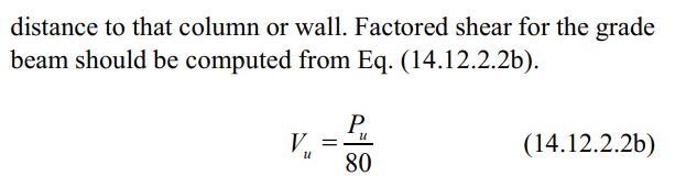

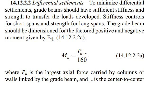

That's close. I suspect that you're really just speaking of generic grade beams rather than true tie beams where the dominant load resisting function is axial. The old school view of grade beams connecting piles, which the world has largely forgotten somehow, was not so much for improving capacity but, rather, for ironing out differential settlement. See one recommendation, below, from ACI 314-11.

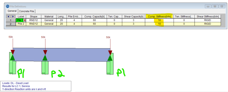

Here's an example using RISA:
- 3 equivalent piles with 50 kip load (red arrows)
- 24"x18" continuous grade beam connecting the 3 piles (density set to zero for this example)

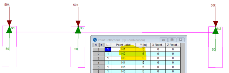

Results show, as expected, each pile has a 50 kip reaction (green arrows):
and settlement is uniform:

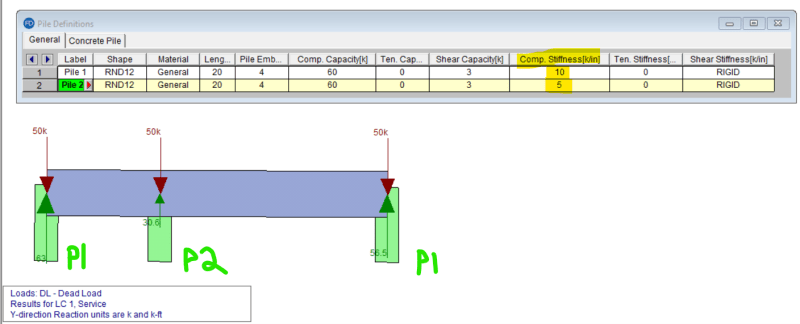

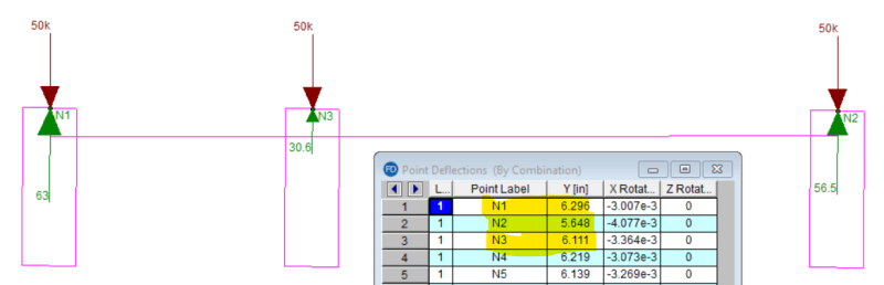

Now say the middle pile has an unanticipated problem that reduces it's effective stiffness. Reducing the stiffness by 50% in the model, we can see the adjacent piles are taking up the load that was shed by the "softer" middle pile:
there is some differential settlement, but not terrible:
The grade beam is necessary to distribute the load out to the adjacent piles. Without the grade beam, the settlement of the middle softer pile would be: (50 kip) / (5 k/in) = 10 in, while the settlement of the outer piles would remain at 5 inches.
