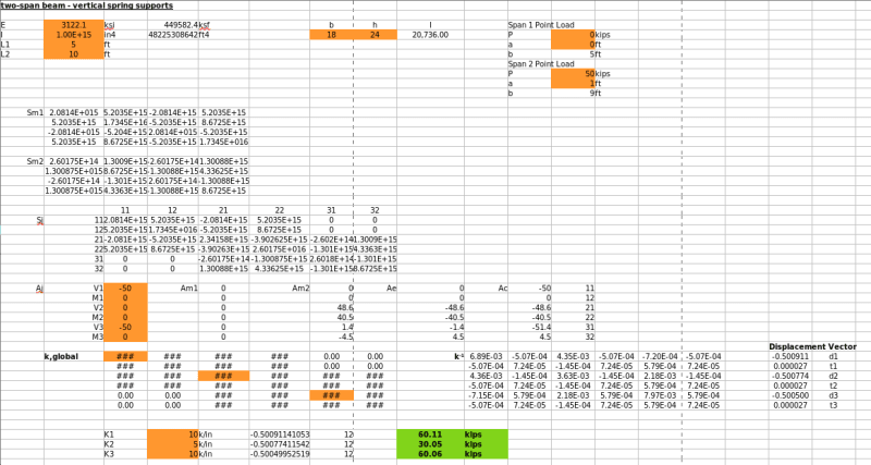

Geotechguy1, I got Excel to within a few percent of Rise results just using superposition and 6 iterations of the full span calculating deflection at loading point above the central pile against the pile's deflection and load stiffness factor. Doug Jenkins' blog at

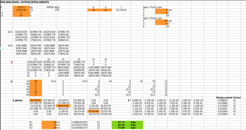

First using Bones206 example:
For the 24" (tall) x 18" (wide) beam assuming F'c= 3000 psi and no stiffness reduction
Code:
E	3122.1	ksi	449582.4 ksf
I	20736	in4	1	 ft4
L1	5	ft
L2	10	ft
For all of the below matrices length has been taken as feet for consitency
The stiffness matrix for the 5 ft span beam is:
Code:
43159.9104	107899.776	-43159.9104	107899.776
107899.776	359665.92	-107899.776	179832.96
-43159.9104	-107899.776	43159.9104	-107899.776
107899.776	179832.96	-107899.776	359665.92
The stiffness matrix for the 10 ft span beam is:
Code:
5394.9888	26974.944	-5394.9888	26974.944
26974.944	179832.96	-26974.944	89916.48
-5394.9888	-26974.944	5394.9888	-26974.944
26974.944	89916.48	-26974.944	179832.96
The global system stiffness matrix inclusive of the Pile Springs is, Kglobal:
Code:
43279.9104	107899.776	-43159.9104	107899.776	0	0
107899.776	359665.92	-107899.776	179832.96	0	0
-43159.9104	-107899.776	48674.8992	-80924.832	-5394.9888	26974.944
107899.776	179832.96	-80924.832	539498.88	-26974.944	89916.48
0	0	-5394.9888	-26974.944	5514.9888	-26974.944
0	0	26974.944	89916.48	-26974.944	179832.96
Because we are looking at this as a 2D problem and the vertical supports are springs then all joint displacements are unknown, and we know the joint loading is 50 kips at each joint. P*Kglobal^-1 = delta
Kglobal^-1:
Code:
0.005974863434211	-0.000490054673319	0.003537704848684	-0.000482185804678	-0.001179234949561	-0.000466448067397
-0.000490054673319	8.33763749299879E-05	-9.82513233548591E-05	7.38899760184168E-05	0.000588305996674	6.60386099950961E-05
0.003537704848684	-9.82513233548595E-05	0.003026776060308	-0.000110054626316	0.001768852424342	-0.000133661232237
-0.000482185804678	7.38899760184169E-05	-0.000110054626316	7.5498754980889E-05	0.000592240430994	6.75948811060119E-05
-0.001179234949561	0.000588305996674	0.001768852424342	0.000592240430994	0.007743715858553	0.000600109299635
-0.000466448067397	6.60386099950961E-05	-0.000133661232237	6.75948811060119E-05	0.000600109299635	8.1828855127665E-05
resulting Delta vector, deflection is in ft for consistent units:
Code:
0.416666666666683
-8.74300631892311E-16
0.416666666666678
-9.22872889219661E-16
0.416666666666669
-9.5062846483529E-16
From spring definition we know P=k*delta --> K=10 kip/in * .416666666 ft * 12 in / ft = 50 kips @ each spring
Setting the central spring to K=5 kip/in
k,global becomes:
Code:
-43159.9104	-107899.776	48614.8992	-80924.832	-5394.9888	26974.944
and the Delta vector becomes:
Code:
0.524735252368115
-0.003001347487258
0.509127576229035
-0.003361910708932
0.470700959517384
-0.004083037152281
Which produces the following reactions:
R1 = K1*delta1 = 10 kip/in * 0.52473... ft * 12 in/ft = 62.9682 kips
R2 = K2*delta2 = 5 kip/in * 0.50912.... ft * 12 in/ft = 30.5477 kips
R3 = K3*delta3 = 10 kip/in * 0.47070... ft * 12 in/ft = 56.4841 kips
to expand on that calculation:
- Shear deformations where not included, that will soften the beam
-!! with equal springs and loads applied at the springs the beam has no impact to the reaction distribution.
- In real life conditions will rarely match the idealized analysis model, so there may be pockets of poor soil which would impact the pile settlements and that is where the tie beam would really be helpful in limiting the relative pile settlements so that the differential settlement is within a tolerable range for the structure above.

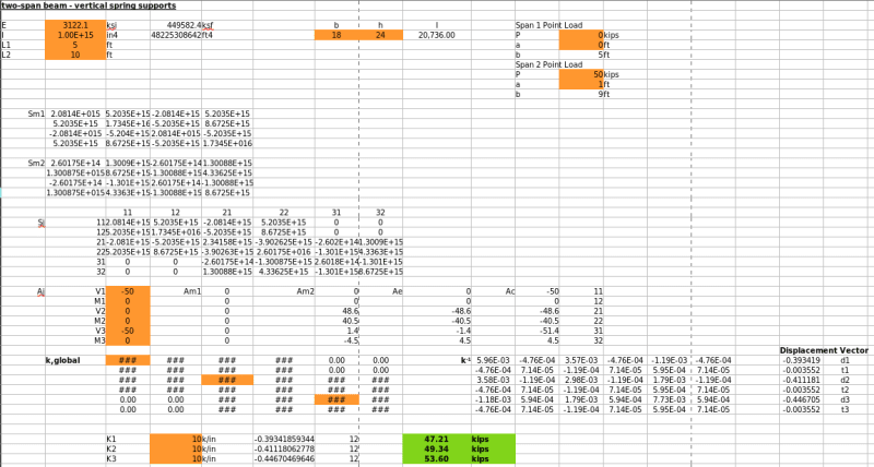

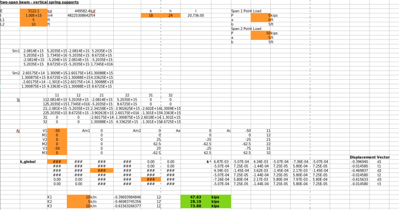

To address your "small" and "large" eccentricity question.
"small" eccentricity - constant springs and same beam as previous example
as above with a very very stiff beam
"small" eccentricity - interior spring = 1/2 K
as above with very very stiff beam
"Large" Eccentricity - interior spring = 1/2 K
For the small eccentricity cases you can see how the "very very stiff" beam case really works to equalize the displacements. However for the large eccentricity case you can see how no matter how stiff we made the beam the load distribution doesn't change much.
