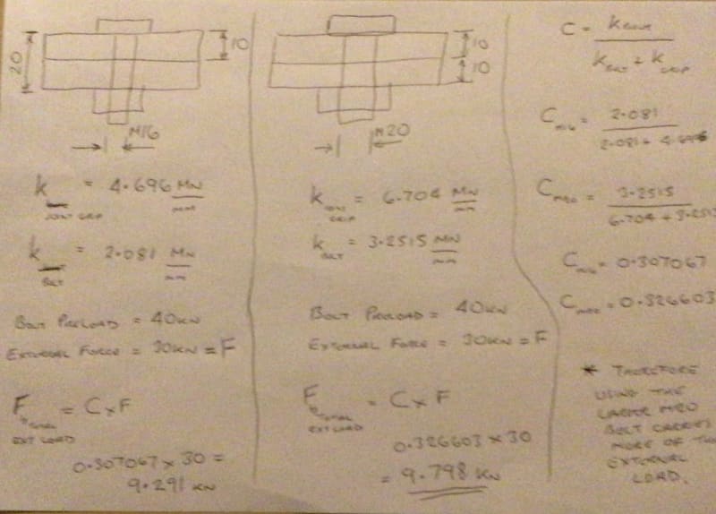

I did a quick calculation on a joint up using an M16 and an M20 bolt and assumed a external load of 30kN was placed on both joints, initial preload for both bolts was 40KN although that didn't really come into the equation for what I was trying to show.
Based on Shigleys Frustum on this link I worked out joint and bolt stiffness.
Based on page 27 of this link I got the formula for the ratio of load taken by bolt and that by the clamped parts:-
The final conclusion was that using the larger bolt transferred more of the external load to the bolt than with the smaller bolt which I believe the OP wanted to know. There was a change in joint stiffness due to the increased bolt size which was expected and the actual external load transferred to the bolt was marginally but this would probably increase had I used a bigger step between the bolts.
I will post the calculation shortly.
Here’s the calculation

There are a couple of other points, one being torquing or preloading screws and bolts to 60 or 90% of there proof strength, this is okay provided the material that’s being clamped under the head of the bolt/screw doesn’t exceed its yield stress when tightened.
Another point is that with the larger bolt the joint separation force increases.
Fs = external force/ (1-C)
So in that example I gave C for the M20 bolt = 0.3266 and C for the M16 = o.3070
Staying with the 30KN external force then the separation force for each situation is:-
Fs= 30KN/(1-0.3266) = 44.55KN and Fs= 30KN/(1-0.3070) = 43.29KN
