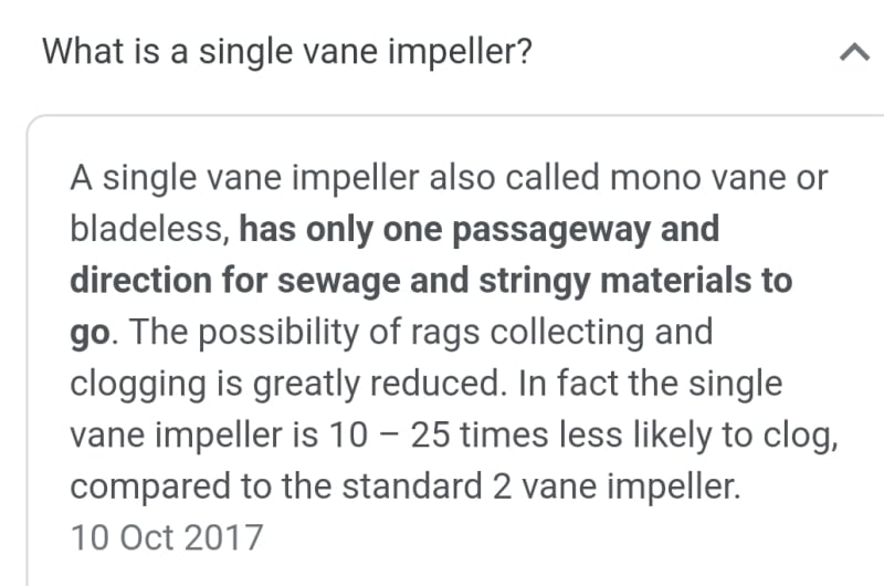

That is an odd pump. There is only one impeller vane. It looks like it is not even balanced.

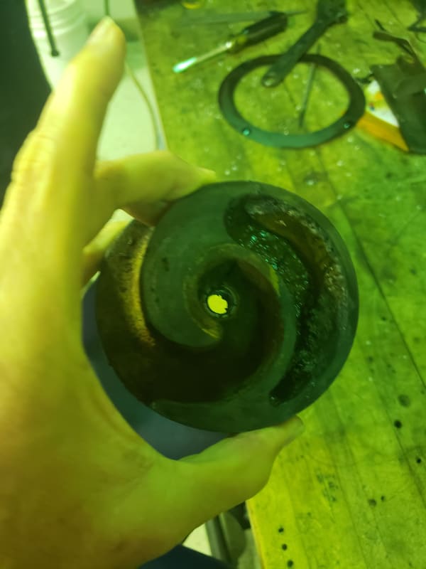

Here is another view of the impeller. It rotates at 3500rpm. I'm sure others could explain better than me why it's shaped that way. There is a dead / void space which I think is supposed to help maintain balance (it would be further out of balance if the void space was filled). But gunk accumulates in the void space.
Now that you mention it, I guess this design would cause a hydraulic unbalance force too, but I have no idea how much.

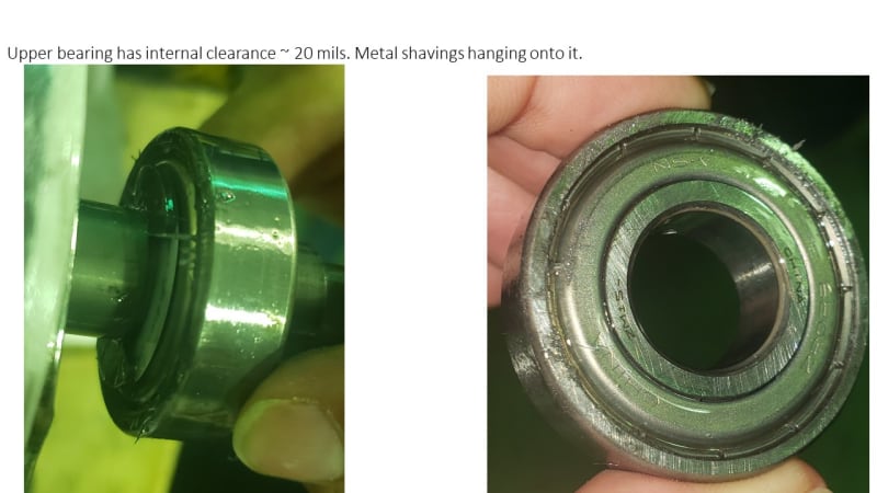

I guess I should have mentioned there were metal shavings clinging to the upper bearing as if it was magnetized (slide 8). I can't explain it, so I tend to discount it as irrelevant, but you never know...

I would bet the farm that the impeller has been balanced.
Yes you're probably right that attention was given to mechanical balance in the geometry of that impeller (I think it's cast). I'm not sure if the OEM went the extra step to do a rotating balance check. Thinking about that gunk some more, it's probably roughly the same density as the water it displaces, so maybe not much effect on mechanical unbalance. At any rate, we will be able to check and quantify the mechanical unbalance by putting the rotor and impeller on a balance stand.
But the fluid unbalance (based on lack of angular symmetry of the pumping action) is a different matter. What do you guys think about that... could that be a significant force?
I'm just trying to think of things that may have affected both bearings in such a short time (5 months since install)
Next steps will include inspection of the bearings after they are cut apart (to see if they held onto any clues about their killer!).

Nothing unusual with the impeller, it's simply a single channel design, and would be balanced during its manufacture.
I think the issue is what effect that layer of compressed dirt in the hole part had on the balance of the impellor. The dirt you can see in the photo two above I think would be enough to unbalance it and create vibrations sufficient to damage the bearings.
Leaving a hole like that in a dirty water pump doesn't look like a great idea to me.

Regarding mechanical unbalance, my first thought was build up of gunk would be a problem. My second thought was maybe not because the density is probably not much different than the water it displaces. Now my third thought: how do I know that chamber will be filled with water instead of air. I don't think there is an escape vent on the top. What prevents a bubble of air from remaining trapped in that chamber indefinitely? In that case the gunk is again important because it's displacing air instead of water.
Some unimportant rambling:
So to put it in perspective, what is the unbalance importance of that entire void assuming filled with water:
Below is a rough discussion / calculation that suggests that the difference in unbalance of that void space if filled with something at water density would not be insignificant:

Two months later, we just got the dissected bearings back from our machine shop (what lightning speed ;-) )
I don't have photos yet but I'm posting here to make sure the thread stays open (I don't know the expiration date of threads).
First impression on inspecting the dissected lower bearing (which was previously noted to have excess clearance while assembled)
[ol 1]
[li]* The inner and outer races don't show any obvious distress at first glance other than possible scrape marks on the elevated "lands" on each side of the spherical rolling elements (people tend to giggle when I say balls)[/li]
[li]* The rolling elements DO show severe wear with multiple obvious pitting sites on each one.[/li]
[li]* I can easily pass the rolling elements back and forth through the cage pocket. I don't think that's normal. These are tiny fabricated cages. I know you can't pass the rolling element through the cage in the fabricated cages of larger bearings, typically when those are dissected they cut the cage into two arcs and the rolling elemetns remain in each half... in this case the rolling elements just fell right out of the intact cage). I haven't looked at many tiny bearings before, but I don't think it's normal for tiny bearings either, is it? If it's abnormal, then I'll take it as an indication that the wear / damage of the rolling elements was severe enough to make them smaller than original.[/li]
[li]* The cage has scrapes as if it contacted the inner and outer race lands on each side of the bearing. These are much more obvious than the scrapes on the lands themselves (I think the race is much harder material than the cage).[/li]
[li]* There were metallic shavings in the grease, presumably from the cage wear. [/li]
[li]* Maybe the decreased diameter of the rolling elements resulted in the cage being less constrained in position, hence it rubbed the land. I can't really imagine the opposite scenario that the cage rubbed in the non-worn condition resulting in debris that created the rolling element wear[/li]
[li]* What is the original problem that would have resulted in rolling element wear (assuming that came before cage rubbing land), I have no idea.[/li]

Repeat of lower bearing findings, with some edits in red. Photos attached.
electricpete said:
[ol 1]
[li]* The rolling elements DO show severe wear with multiple obvious pitting sites on each one. (slide 5)[/li]
[li]* The cage has scrapes as if it contacted the inner and outer race lands on each side of the bearing. These are much more obvious than the scrapes on the lands themselves (I think the race is much harder material than the cage). (slides 2, 3, 4)[/li]
[li]* There were metallic shavings in the grease, presumably from the cage wear.[/li]
[li]* The races were both magnetized[/li]
[/ol]
Upper bearing findings:
[ol 1]
[li]* The rolling elements have large rough patches. Usually there is a pattern of a large band of rough surface centered on an equatorial line, with smooth circles where the poles would be (slides 7 and 8). Maybe it suggests the rolling element spin axis was not changing, or that sliding was occuring.[/li]
[li]* The rolling elements are not as loose in the cage as the lower bearing. We did manage to get one out and used the cage pocket for comparing the size of the rolling elements and the rolling elements from the lower bearing. The rolling elements from the lower bearing could easily go through the cage pocket. This is either due to a smaller diameter or less roughness.[/li]
[li]* The wear of the cage against the outer ring does not appear to be as severe as the lower beairng.[/li]
[li]* Like the upper bearing, the races were magnetized and metallic shavings were found.[/li]
[/ol]
Considering the poor condition of the rolling elements and relatively good condition of the races, it also raises a possible scenario of bad quality bearings. I'm less inclined to think it was operating to the left of the curve that beat up the bearings, but who knows.
What do you think caused the bearing failure?

Simple answer to what caused the problem is clearly shown in photo 6/8 - "China"
I noticed that too. The brand is NSK. I would say they're more reputable than most Chinese bearing brands (they are certainly more familiar). Then again, counterfeit bearings are a thing.
I've never seen rolling element damage anywhere near this bad without a hint of spalling / damage to either inner or outer race (*). It leads me to wonder if the rolling element material was substandard. Has anyone seen that type of thing before?
(* then again I don't normally look at bearings this small... 6203).
