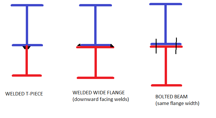

Hi all. I though I'd throw this question out to the masses for a few ideas.
I need to seriously stiffen some members due to some vibrational issue. Cost of steel isn't really the issue it is more labour and looking for the easier and quickest solution to stiffen some existing beams. I'm mostly looking at three options and are after opinions but other suggestion are welcome.
I also want to know how effective bolting beams together can be and whether adequately rigid shear connection can be achieve to ensure that the beam acts compositely with the added member. I would presume slip critical bolting would be required and so make the whole process more difficult and possibly impractical.
Options I'm considering:
1: Welded T piece
2: Welded Wide flange (advantage being downwards facing welds)
3: Bolted member identical to existing (advantage being avoids site welds, but might be negated but number of bolts and slip critical requirements)
Overall I'm thinking option 2 is best but I'd like further input, particularly regarding option 3. Thanks. [thumbsup]
I don't think bolted is a good idea. Vibration will inevitably loosen the nuts and relieve pretension.
Not sure how bad your vibration issue is, but conceptually, I think #1 with a CJP weld is probably the soundest option. Gut says #2 could be susceptible to cracked welds.
If it's an option, I'd consider isolation dampers for whatever is vibrating before doing anything structurally though.

I agree with CrabbyT,
If you are after stiffness Option 1 is the way to follow. Think about other option on how they will transfer load and vibration. Especially the third option is not going to provide proper stiffness, but it may partially or fully dampen vertical vibrations with friction if the bolts can stay without getting loose (that is a question).
Option 1 is common and with normal fillet welds. Depending on the loading and use the fillet welds can be intermittent. Because of vibration intermittent weld should not be used. Option 2 is less common but can be done due and has the advantage of downturn welds (or whatever people call them), with the same caveats as Option 1. I've not seen Option 3, but about a year back I was involved in a project where the owner had an S section crane beam that the bottom flange was badly worn and he wanted to remove the bottom flange and bolt a WT section to it using slip critical fasteners. (There's a thread somewhere on the site) I didn't like the T to T connection due to eccentricity and used plates on each side. The work they did in the plant precluded welding. In 50 years, it the only time I've used bolts for this type of work. [pipe]

Yes. I think it is best to stick with Option 1. I had already figure that was the preferred structural solution, but requests were made for a solution that could be more easily implemented. I think I'll stick to the tried and true approach rather than being all too clever.
OP See the added note about intermittent welding... [pipe]
For third type solution
bolts loosening (due to vibration) could be prevented by Nord-Lock [Wedge-Locking Washers]
Link
Hi human909
My only concern about option 1 is whether you can size the welds such that fatigue cracks aren't an issue, also how do you know that the section you are providing is correct to stop the vibration that the beams are seeing?
If you were to bolt a section onto the existing beams and use Norlock washers as adn26 mentioned you could try different sections till you get a solution whereas once a stiffener is welded its not as easy to replace.

Unless you are not permitted to weld, I am not sure that your bolts would be cheaper. If the existing section is bent, bolt alignment would be great fun. So would the reality of using a mag drill to drill and an endless number of bolt holes in the field that need to align with the off site fabricated parts +- 1/16".
@human909: is this a vibration problem associated with truly vibratory loads (machines etc)? If not, more permissive things may be possible.
Lots of folks seem to like your option #2 these days, for exactly the reason that you quoted. And, properly handled, I think that could work here.

I've only ever used option 1 as a repair myself - if you to go cheap, you can just sit a beam directly below the existing beam and assume no composite behaviour at all - just the additive stiffness of a second beam. Personally, I'd bite the bullet and weld the T.
I want composite behaviour to get suitable stiffness. I'll be going from a natural beam frequency of 12-14hz (a calculation, TBC on site) to at least double that.
Just to confirm. Your preference for the T is because of fatigue cracks in option #2? Or is it some other reason.
My preference for the T is just because that's what I've done in the past. I'd have no issues with sketch #2 if the weld is easily accessible.

I expect the solution I will choose be option #2 and I have already done initial calculations for suitable member sizes. But I am doing site investigations at 2 different sites to ensure I can properly model and understand the behaviour before just blindly throwing steel at the problem.
In case of vibration I do not like fillet weld goes in bending in cross direction. Option 2 will have this. You need to think about the vibration contribution of the lower beam (mass)to the system since they are connected at flange ends, and behaviour of fillet weld. You may probable be obliged to investigate the system by FEA.
Additionally, some time later they will see a beam look like too strong (Option 2 scenario), and it will be additionally loaded without even looking at its load path. You should be ready and provide warning on your drawings for additional investigation for this kind of scenarios, perhaps written warning underside of the beam.
I will go to option 2 or 3 modified version
Option 3
Bolt 2 beams together, and do all around fillet weld, bevel if you have to, plus, some slot or plug weld, this way you combine the strength of the bolt and welding together at the cheapest cost
on option 2, you can omit the bevelling
