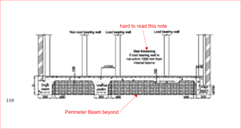

Good day, I am trying to model this type of raft slab and stiffened beam on staad pro.
My question goes thus
[ul]
[li][/li]
[/ul]from my few years of experience on raft foundation, the slab is designed with the net upward pressure. so now I have a beam and slab. does it mean some of my net pressure would be transferred to the beam
when I modelled my raft slab on staad pro with elastic mat Foundation. I got the same results using my manual method. but when I decided to add beams to split the slab I noticed my plate moments reduced. now my superior colleague is saying something is wrong with staad, as all the pressure is supposed to be on the raft slab.
 https://files.engineering.com/getfile.aspx?folder=779e9561-556f-4f88-8392-16b61b4371b2&file=2B77637F-DBCA-4534-B6D4-9404285777FA.png
Your sketch is a little hard to read (see below), but if you have perimeter beams on all sides, then the beams you show in cross section will help to distribute the load. Even the slab thickening will help, but not as much as the deeper beams. As a result, the plate moments will be reduced. I don't think there is anything wrong with staad.

I can't read your sketch either.

@WARose let me try to explain.
if we have a load of 1000kN coming from the super-structure and the base area of 10m x 10m
it means the total pressure on the soil is 1000kN/100m[sup]2[/sup] that is 10kN/m[sup]2[/sup] so it means the load coming on the raft is 10kN/m[sup]2[/sup]. that was what I meant by the net upward pressure
it means the total pressure on the soil is 1000kN/100m2 that is 10kN/m2 so it means the load coming on the raft is 10kN/m2. that was what I meant by the net upward pressure
Ok but that isn't a "net upward pressure". If it was, your foundation would be unstable. But anyway, now that I get the question.....the answer is: yes, some of that will wind up in the (perimeter) grade beam if the connection [slab to beam] can transfer it.
