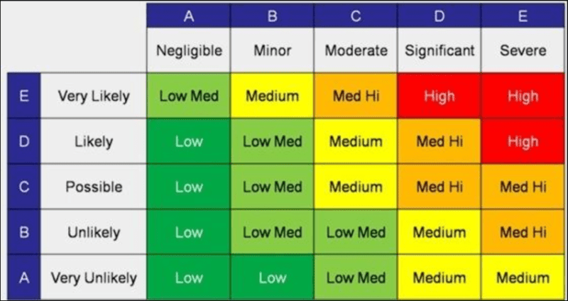

Getting back to the probability thing, is there a database or ready made statistic anywhere where you could say something like,
Based on 1000 structures ( or whatever number you take),
A new structure designed to IBC and built to plan made of concrete and steel - chance of one collapsing in the next 12 months is ??0.1, 0.01?
New PEMB - same thing - 2.5??
This PEMB in its current condition - 100?, 200?
If its windy multiply by 2, Snow 5, earthquake 10
Always helps to put it into context and let people assess the risk themselves. Everyone has a different "risk appetite". Like most things it tends to peak at about age 25, then fall gradually over time.....
