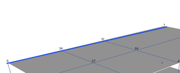

Hello,
Is there a Python code to provide joint information on a Line Element? For example, the blue member shown below is one piece, and I can read the end joints and all forces, but this doesn't provide much help for internal connections and forces. Is there any other way to get data for each segment?
Below is the a partial code used to read the forces.

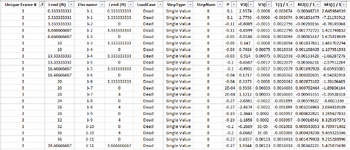

Thank you S&T for your response and link to the post. My output for the blue beam (Frame #3) is shown below. The bays are 10', 10', 20'. I am not sure how to create three segments from this data.
My bad, i thought that this was (3) individual line (frame) segments already broken up.
It would be helpful to see the applied loading to the element and see what you are trying to retrieve. Can you post some more info?
It looks like in your output, there is an applied load at 3.33 ft in, shear jumps from 2.7796 to -0.8089. Is that right/what you are trying to get?
