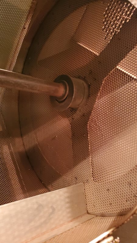

I have a bean roasting application where there's a perforated rotating horizontal stainless steel drum in an oven.
Max temp is 375°F (200C)
We're trying to get the temperature of the roasting contents as it tumbles in the drum.
Easiest would be a temp transmitter inside the drum but there aren't any batteries that will put up with 200C.
Any ideas?

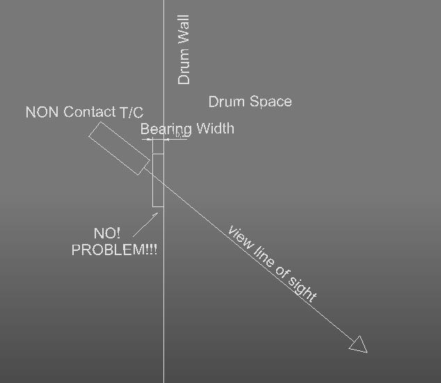

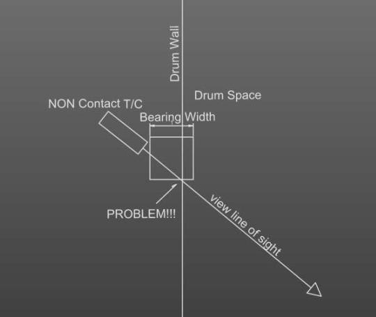

Bill; I like the cam follower. Unfortunately all I find would cause bad geometry issues because they tend to be thick and with long studs.
Cam followers would force the support shaft to be way too long blocking the view to the bottom of the roasting drum.
Looking for a Flange Mount Bearing is causing the same dang problem because any that have a 2" ID, helping the non-contact T/C get the angle to see the bottom, expect to support thousands of pounds and so have extremely wide bearings.
Anyone have a thin idea?

Hadn't considered that. See the picture of the rim above. Think it would work?

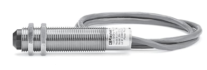

How about this..
Given the drum is like this.
Cut a single hole in the side of the oven.
Mount a non-contact T/C in the hole looking at the side of the drum just above the end spider outer ring.
Mount it so it sees the three spider bars as they pass in front of it but otherwise see's the beans thru the perforations just above the ring.
This sensor has a 350ms response time. I should be able to see the oven temperature looking at the spider arms VERSES the bean temperature when the spider arms are elsewhere.
The difference between the two will show the difference between the beans and the oven itself.
Keith Cress
kcress -
I like that idea of comparing the spider arm temp to the perforated steel/product temp.
I don't follow the IR market so I don't know if that Raytek temp sensor is a wideband, linear 4-20mA model or whether Raytek has adopted a line of the cheaper units that are a thermocouple thermopile with a bowed response over some relatively specific, narrow temperature range and which expect a T/C analog input with CJ compensation (like an Exergen non-contact sensor).
When screen is passing by, the IR will 'see' a signal that is the combination of the relatively low emissivity heat emitted from the perforated steel and the relatively high amount of emitted from the product and when the spider arm passes the signal will be the low level emitted heat of the steel, biasing the reading toward the organic, but on the low side because of the steel contribution.
The linear IR's always have an emissivity adjustment and my memory from years ago recalls that 'back when' the Exergen thermopiles expect the AI to do an offset for emissivity. Assume you use adjust to a higher emissivity to read the organics.
If the exterior steel is all clean and shiny, it wouldn't surprise me if the spider arm temperature was perceived/indicated as a lower temperature than the organic product because organics typically have high emissivity, so they emit more heat than the steel and the sensor emissivity is set high. If any of the steel is dirty, then high emissivity dirt affects the reading. Spray painting the spider arm flat black (automotive exhaust spray paint) will make the spider arm steel high emissivity and get you close to the actual steel drum temperature. I think you'd want shiny perforated steel to reduce the contribution of low emissivity perforated steel heat and maximize the contribution of organic product heat to the sensor.
Field calibrate the temperature reading by stopping the drum, inserting an RTD hand probe and taking an reading to determine your 'real' temperature and either tweaking the emissivity adjustment (don't let the operators see you do it and glyptol the adjustment screw when you're done) or add the difference between reported and real as an offset in the temp indicator.

danw2; I just grabbed an example non-contact T/C for illustration. Raytek has a dozen different models and there are about 6 different companies that make them. You can get every kind of output you can think of so I suspect I can find one that will be sufficient. I like this one as I can use a meter and a simple hole in sheetmetal and try it to see what happens. A completely different job than having to come up with a different bearing system for the drum. If the $200 probe doesn't work a screw and a little square of sheetmetal repairs the test modification.

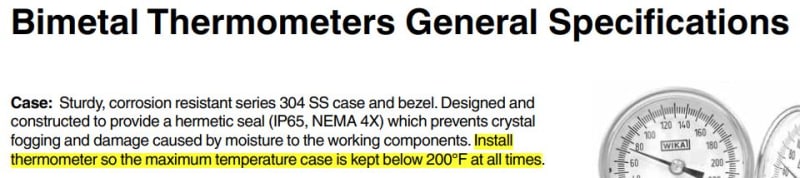

You need to watch for the case temperature limit for the bimetallic thermometer (old school low tech). Wika limit is 200 DegF:
and it's likely that other manufacturers' specs are around that same number.
But could you put the probe through a flat sheet of aluminum or SS shield to prevent radiant heat from getting to the case/dial assembly in order to keep the case temperature down? Conductive heat through the probe would be minimal.
