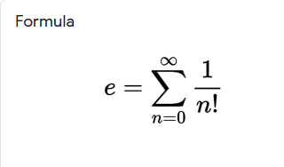

This is based on:
Or more simply:
1/e
Please don't think of me as irrational. grin
