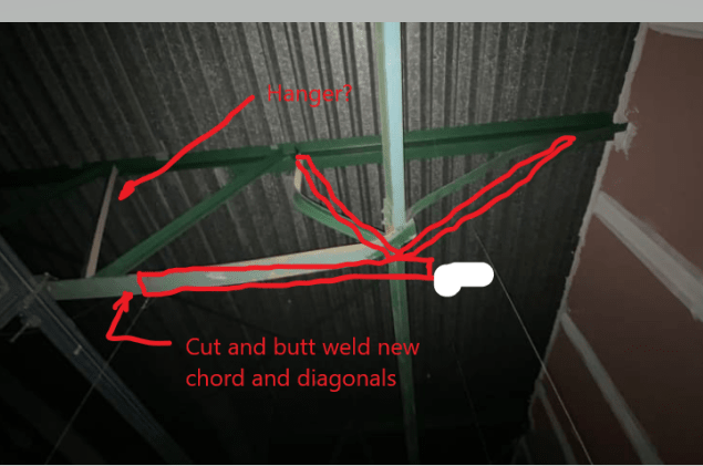

I was called out to look at this truss which has failed. Its a Steel warren roof truss. The layout is shown below - but I’ve crossed out the vertical which doesn’t exist - which I think should have existed!
It looks to me as though the second last diagonal, the compression member buckled due to excessive compressive force, and as it buckled it pulled the last diagonal, which should be in tension, causing it to buckle also.
Any thoughts on the mechanism? There are hundreds of these trusses throughout the building and this one has failed.
Disclaimer - not my design!! I just got asked to review this failure!

The new load on the bottom chord makes a lot of sense, especially since it looks to be localized near the end of the joist. Now that we know it's there, I agree that it's a likely culprit. That clamp connection looks terrifying. I see the unistrut markings - is it zinc coated? If not, and it's just bare steel, I'd be less likely to accept that as the reason as the joist bottom chord has rust where the paint has been damaged.

This was built circa 1995. The trusses are 1000mm deep and the fiagonals are typically 50 x 50mm angles - so not something you’d damage by falling against.
It certainly could have been damaged by a forklift etc but I really don’t see it. This is a data hall. There’s no moving machinery etc. That’s not to say it didn’t happen during construction but again, I really find it hard to believe given its age and the fact that this is the only truss supporting heavy services and is the only one that’s failed.

From your newest picture, it looks like the damage has been here for quite some time as the dust and dirt on the chord appears to be uniform. If this was something that was new, the dust would not be uniform on the members.

The most likely culprit is the additional load hanging from the bottom chord near the end of joist. The second diagonal failed in compression, causing the end diagonal to pull the end of the bottom chord up. Rotation of the bottom chord caused the kink in the end diagonal.

I'll put my money on a manlift (scissor lift work platform).
The workers were going up with the manlift and not paying attention as they elevated the platform. The last two web members were "lifted" by a force coming up from below, i.e., the handrail around the manlift platform. The worker(s) involved aren't going to tell anyone if no one saw it happen. Their employer would have to pay to get it fixed the they would be out of a job.
There are sprinkler pipes that were installed after the structure was "completed". You have wall panels that had to be placed. You have the metal studs erected. Workers often use the manlift to hoist materials during construction. They are looking at something that has drawn their attention from watching the other end of the platform and bingo, they hit the underside of the node with the handrail around the platform.
One way or another that end of bottom chord got a whack going upward. Not load related at all.

Probable fix, if required. Add hanger if it is not there already.
What's the bottom end of those extrusions look like? I wonder if they've been taking the load that should have transferred to the end of the truss. Probably best to leave them in place until a repair is made.
