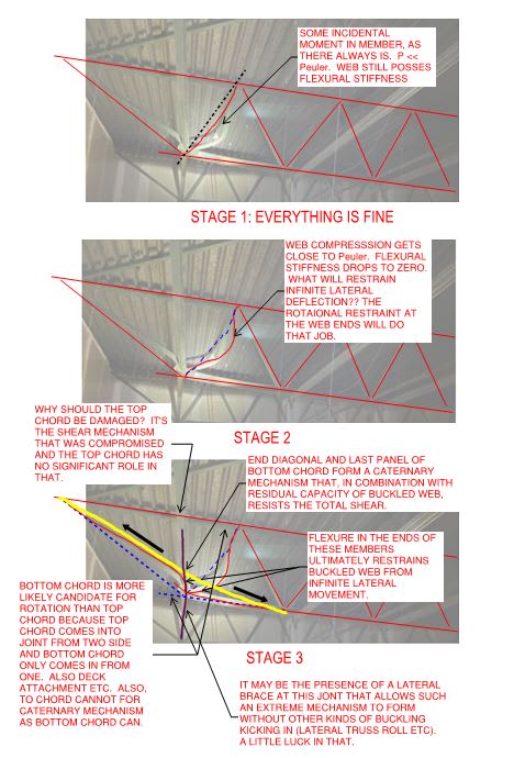

I was called out to look at this truss which has failed. Its a Steel warren roof truss. The layout is shown below - but I’ve crossed out the vertical which doesn’t exist - which I think should have existed!
It looks to me as though the second last diagonal, the compression member buckled due to excessive compressive force, and as it buckled it pulled the last diagonal, which should be in tension, causing it to buckle also.
Any thoughts on the mechanism? There are hundreds of these trusses throughout the building and this one has failed.
Disclaimer - not my design!! I just got asked to review this failure!
Interesting failure. My guess is the additional load from the hangers has caused the final compression member to buckle, rotating the node and adjoining members.
Do you know the magnitude of the loads? If the truss has failed due to overload then are the other trusses safe?
It wasn't caused by overload, but the heavy localized load may have contributed to the buckling - upward forces near the joist end meeting the confining force near the first hinger, resulting in excessive compression in the web members. The roof was confined by the heavy load, so it remains flat, evident by the unaffected top chord.

I will be doing analysis shortly, going into it with an open mind, and lets see how much compression was in that last compression diagonal.
The key for me is whether there is any deflection in that top beam.
If not then it got whacked from underneath at some point seems to be the consensus
If there is actually a visible or measurable dip or bend in the top T section then it could have been buckling under additional compressive force caused by the additional weight applied.
But the fact that the beam looks like it is surviving and hasn't apparently bent is very interesting. I can't see how the elements would bend that much without the top chord moving downwards and creating a hinge at the junction of the 2nd and third diagonal.

With every fiber of my being, I've wanted to believe that you did not, in fact, observe a unicorn. And by "unicorn" I mean a genuine, theoretically predicted, overload buckling event. I wanted it to be some pragmatic, pedestrian thing to do with forklifts or misbehaving construction workers. The usual. But, alas, I've come to the conclusion that your original explanation is my preferred explanation for what has actually taken place with this truss. Unicorn.
Below, I've attempted to tell a cohesive story of this truss failure as it might occur via overload. I haven't actually added anything to what has already been tabled above. What I have done, is attempt to put a bunch of it together into one cohesive story. I've also presented things as though they might have happened in sequence which is false. Obviously, all of this stuff would have happened, progressively, in unison. I just find it easier to conceptualize it this way.
human909 said:
The truss largely remain load supporting due to catenary action from the last tension angle and bottom cord.
I feel that aspect of things (yellow line below) is very important to the story of this failure and did not garner enough attention initially. I lean on it in what follows.
Everything below is also attached as a PDF in case others want to sketch over my stuff to show me how I'm wrong etc. Obviously, my theory is still just one theory of many. It's a pretty good story though... princesses and dragons.

I disagree with the bolded part a bit, at least semantically:
1) The last diagonal is in tension and, I suspect, always has been.
2) What you've described as the "buckling" of the last diagonal is really it having been rotated at the bottom in order to keep the second web from compression buckling to the side infinitely. So it is a member currently experiencing axial tension and end bending but not buckling.
3) The last diagonal, as a result of developing the canternary mechanism shown above, has likey had it's axial tension increased as it has effectively become a shallower tension web than it originally was. I'm not sure "caternary" is technically the right term here but human909 chose that so I rolled with it. I'm sure that we all get the gist of it: a thing that moved and resisted greater shear in having done so.
Nicely presented, KootK. I think you have nailed it.

My concern with this as an explanation is this - how much energy was absorbed in that amount of distortion and where did that energy come from? In typical buckling the energy comes from a change in vertical height of some amount of weight, but here no other part of the structure appears to have moved at all.
So how much energy was required and where did it come from?
This is why the energy supplied by a lift is more attractive an explanation.
I agree with your analysis, KootK. I commented twice, once on each side of the argument, but hadn't focused at the time on the loading from those hangers.
