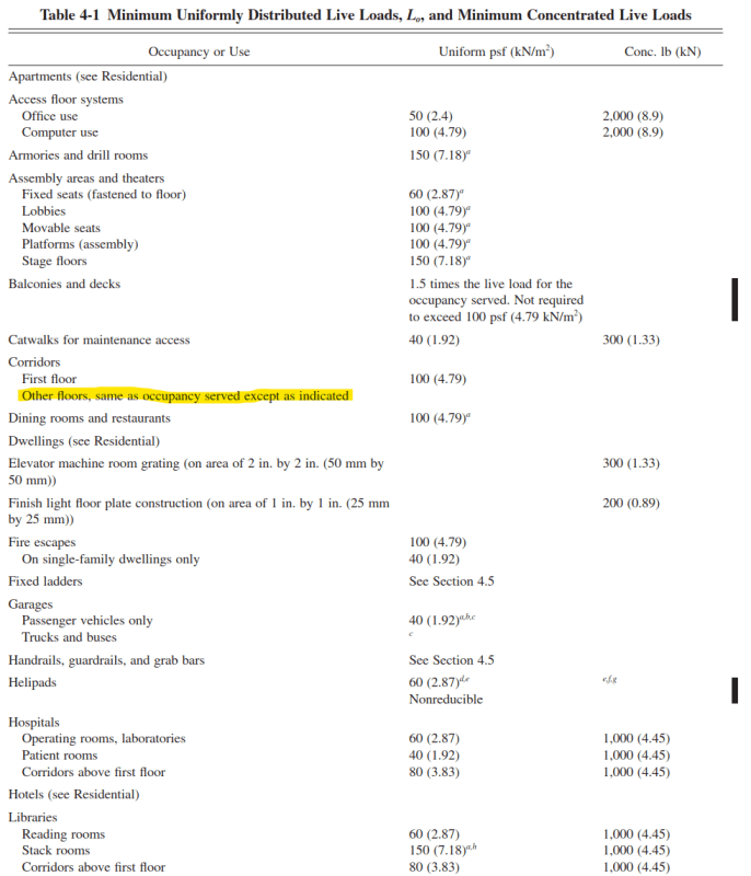

I was asked to check if the columns of a 30-story condominium building are properly designed to today's standards to carry the loads they are supposed to. I can use the ASCE 7-22 for the live load reduction etc, but I am not sure if I should just stick to a 40 psf load for Live load value that is the minimum we recommend. I never design for minimum even though I know that statistically that is already actually very conservative. Sure we have 100 psf for corridors, but even with that, in a plan that looks more like a labyrinth with corridors going around and units in really odd forms, I wonder if I could get a general idea of what is a good average value to consider. With design specifications for f'c of 3ksi, I am skeptical about how conservative I should be. Any suggestions?
Corridors serving residential units need to only be designed to 40 psf. However, if the corridor is connecting an assembly area, that would be 100 psf.

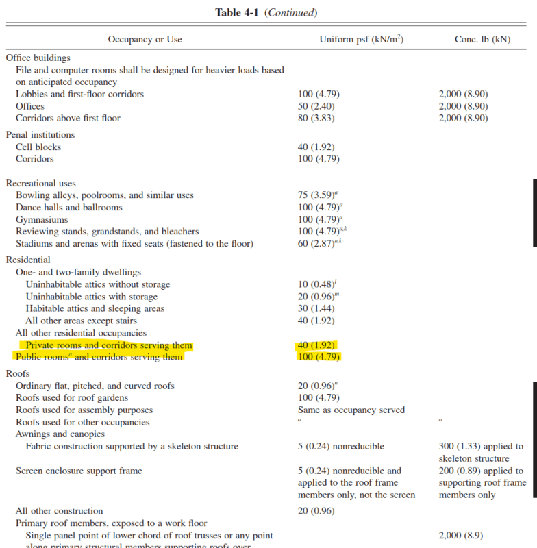

I would design for live load of 40 psf. I personally design corridors to 100 psf, but that's above code requirements if it's only connecting to condos, and not necessary. I know about the 2 sigma rule for LRFD and how loads are made by the code committees; it's just a personal preference for me to overdesign corridors.
If the columns and foundations aren't working, use live load reduction for the columns. There is a footnote in Table 4-1 that live load reduction can't be used on "public rooms," though. I interpret that as recreational rooms, laundry rooms, and things like that.

40 psf for a corridor isn't code anywhere I've looked. Further, egress path is 100 psf. Can anybody clarify that?

@lexpatrie From ASCE 7-10 (hopefully not too outdated):

Going back to the Miami Vice comment, corridors are exit ways. Horizontal exit ways, transfer corridors, whatever you want to call them.
Corridors, the way a lot of these places are designed, the first floor is pretty public, and it's already 100 psf as a first floor corridor. The upper floors I see a lot of folks wanting to use quite a bit less, it doesn't do much for the column design on a multi-story building one way or the other, and in a concrete building it's pretty impractical to reduce the depth if the live load is 40 versus 100, only for the corridor, and I'll stand by the 100 psf. I've seen projects kicked back by more rigorous building departments for using 40 psf in a "private corridor" in a hotel when it's actually for accessing the rooms from the public elevator and the egress stairs. A private corridor is inside a private room.
That doesn't mean that some yahoo engineer didn't design something in 1980 for 40 psf live load and nobody bothered to review it, or for that matter, file the drawings. It isn't all that realistic for, say, a hotel corridor to experience 100 psf, but that's what the code (life safety) calls for, as I've seen it interpreted, so if you're evaluating a design, I think you have to expect all of it to be done wrong and then work to disprove that assumption via generally accepted principles of mechanics and structural analysis and the code in place at the time of construction/design.
It's fairly likely a 33 story concrete building that was designed incorrectly (quotation marks deliberately not provided) for 40 psf exit ways wouldn't be gravely affected by this error (provided you even agree with me on 100 psf, which I rather doubt).

@lexpatrie Thanks for that snippet. It's interesting to me because my local code calls it "Stairs and exits," not "Stairs and exit ways." It changes the meaning quite a bit. I just sent a request for clarification to the building department, and I'll update here in the small chance that I get a response. I feel like if they wanted 100 psf live load for the corridors that serve as exit ways, they would've said so in the corridors section. Because almost every corridor in this universe is an exit way, besides some fancy places that have internal corridors.
