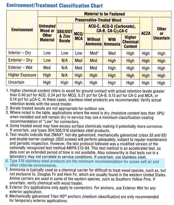

A complicating factor is that there appear to be ways to get reliability by using shortcuts. This may be true, but there are pitfalls for the unwary. For example, in the thread about the North Carolina (not Florida) deck (porch floor) collapse you commented that a Simpson Strong-Tie representative advised you that hot dip galvanized connectors / fasteners (which includes Simpson's ZMAX) were satisfactory for service in typical ocean front service. I saw that you and Hokie66 correctly concluded that this recommendation was wrong. In fact, the Simpson rep missed an important note in his own published literature. Download the Simpson Strong-Tie Deck Connection & Fastening Guide
See Note 6, page 18, an excerpt of this page is shown below:
My point is that taking the Simpson representative's recommendation, without independently checking its accuracy would lead to a design that, for ocean salt-air exposure, was worse than the 1986 concept used in North Carolina.

Thank you for your post, slideruleera. For clarification, the Simpson strong-tie technical rep did not recommend "Z-Max or hot-dipped galvanized equivalent" for marine environments. My call to him was concerning a project that is in an environment that is not that extreme - in Monterey near the 17-mile drive, but about a 1/4 mile from the beach, up in a hilly forested area. I expect this area to get heavy fog on occasion, but not the highly corrosive salt spray one would expect for a structure located right on the beach. In fact, he agreed that stainless steel would be appropriate for marine environments.
