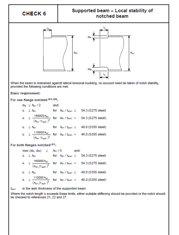

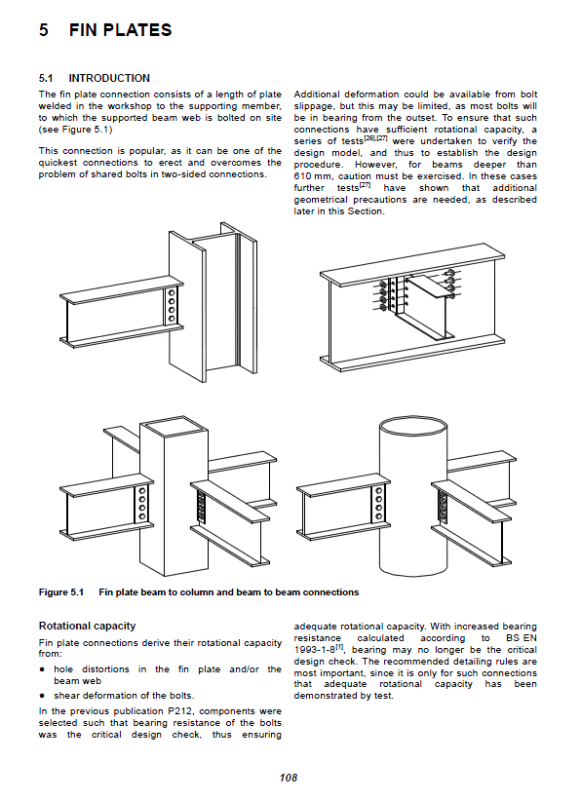

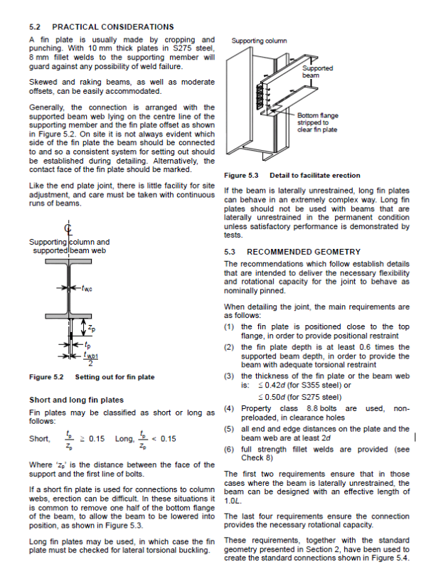

After a long research I got the answer.The direct answer is given in Euro code(Joints in steel construction SIMPLE JOINTS TO EUROCODE 3), please find the references below.
Thank you every body.

The original question is a very valid one. Section F.1 of the spec requires restraint of rotation at beam supports, but doesn't go into any more detail. A simple answer I've come across is in the April 2010 issue of Modern Steel Construction:
It is common practice to provide a connection with depth at least equal to T/2, as recommended for all the framed connections in Chapter 10 of the AISC Manual, to ensure that the proper restraint is provided. It may be possible to provide the required restraint by other means, but the half-depth connection has become a de facto requirement.​

So my approach right now is to make sure that my connections have a depth of at least T/2 and watch out for the following situations:
- large span/depth ratio
- member near capacity
- thin webs
- deep copes
- thin or extended shear tabs
