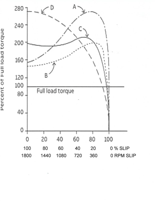

Thank you Curt for confirming my understanding.
A couple of questions:
Are the torque curves of induction motors in electric vehicles similar to any standard industrial motor curves?
Further to this statement:
Curt said:
This limits the slip to the right-hand end of all of the torque curves you show, between the non-load torque and the breakdown torque.
If I start with the curves that I have posted and first, change the index from percent to RPM, with 1800 RPM being 100%.
Now, if I reverse the index so that 1800 RPM is on the left end and 0 prm is on the right end,
and
Last, I relabel the diagram from Percent of no Load Speed.
To
RPM of Slip
Now is this still a valid chart.
And, If we use only the portion between breakdown torque and Zero RPM Slip, is this valid for all speeds except very low speeds.
I find this an easy way to understand and explain VFD characteristics.
Yes, I understand that at very low speeds the accuracy may suffer, but is the accuracy valid for speeds above about 40 RPM to 80 RPM, for a 1760 RPM rated motor?
I understand that the relationship between slip RPM and torque and current holds up at all but very low speeds.
Thanks.
Bill

You've done exactly the transformations I recommend to people trying to understand field-oriented control of induction motors. I almost put these in my last comment, but didn't have the time. I would go one step further and express the slip in Hz as well as RPM.
The next step is to create the generator portion of these curves by rotating the motoring curves you show by 180 degrees about the zero-slip, zero-torque point. Now you have the essentially linear parts of the torque/speed curves covering both the motoring and generating zones.
In direct-off-line (DOL) operation, if the actual load torque changes, the motor accelerates or decelerates, moving on the curve until generated torque matches the load torque. This is true for both motoring and generating. All normal operation is in the approximately linear (monotonic, at least) zone. In the generating zone, it is returning energy directly to the AC lines.
In the field-oriented control (FOC) used in EVs, the controller takes the desired generated torque level (plus or minus) and calculates the slip frequency required to create this torque. The controller needs to know the "slope" of the particular motor's torque speed curve. This slip frequency is then added to the mechanical frequency to get the net electrical frequency to be applied. (This calculation is typically updated thousands of times per second.)
You ask: "If we use only the portion between breakdown torque and Zero RPM Slip, is this valid for all speeds except very low speeds?"
If you can actually measure the speed, especially with a position sensor such as an encoder or resolver, this is valid for all speeds INCLUDING very low (and zero!) speeds. People have used FOC induction motors as positioning servos for over 30 years now.
If you try to calculate the speed from electrical properties, the quality of the estimation degrades at lower speeds (when the back EMF is small compared to various noise and disturbance effects).
With (closed-loop) FOC, you have a constant "direct" (inducing) current magnitude -- at least until you get to base speed -- that is parallel to the instantaneous rotor field orientation. This is typically about 10% of the maximum possible value. You have a variable "quadrature" (torque-producing) current perpendicular to the rotor field, which is in-line with the back EMF in the phases. So to produce this current, you need to command a voltage that is V = EMF + I*R.
The total voltage is the vector sum of these two perpendicular components. At high speeds, the back EMF dominates, so the total voltage magnitude is closely proportional to speed. But at low speeds, the perpendicular voltage to create the direct current has a significant contribution to total magnitude. But the nature of the FOC algorithm handles this effortlessly.
However, with open-loop VFDs, if you want any reasonable low-speed control, you must include this effect in your magnitude calculations. A constant Volts/Hertz ratio can be close enough at higher speeds, but you need a "boost" at lower speeds to provide the inducing current.
