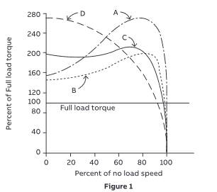

Braking torque characteristics of an induction motor used in an electric vehicle:
The first application is retarding on a long grade.
To avoid overheating the motor, the retarding torque and current will be thermally limited to rated full load torque and current.
The maximum short time braking will be limited by the breakdown torque of the motor.
The breakdown torque varies with the design of the motor.
This Figure from the Cowern Papers shows the torque curves of the standard design industrial induction motors.
The design B is the most common design with a breakdown torque of about 200% of rated torque.
The main factor in the torque curve of a motor is the rotor design.
The resistance of the squirrel cage as well as the shape and the distance below the surface of the rotor affect the curve.
The maximum or breakdown torque of a design a or design D industrial induction motor is about 280% of rated torque.
I have no idea of the design choices of the electric vehicle motors.
The braking energy of the motor drops as the speed drops, however the braking torque remains constant down to about two times the slip speed.
