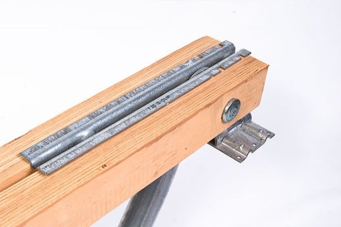

A little googling turned up this pic of a bearing seat joint. It's more robust than what I'd imagined. Do you see any evidence that your seat joint is something like this??
No, there's not much for a bearing seat at all.
