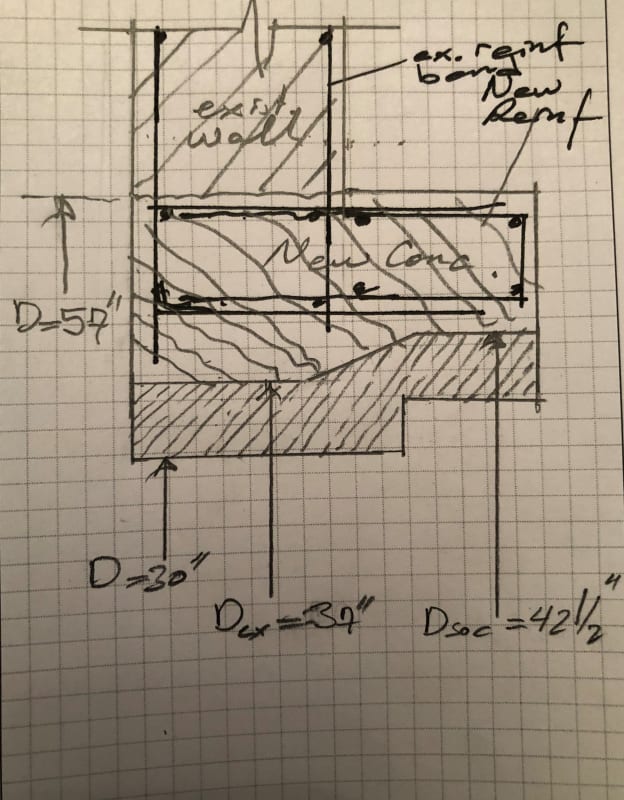

I would core the 16' side wall with dia 60 in. then cut and bend the existing reinf. towards outside add new rebars then construct a RC square reinf. pad / neck at extior side with dims. 70in X 70in and thk 10 in.

The pipe is a 30in RCP, 37in OD, assuming a 42" core. To clarify, remove concrete and preserve the reinforcement, cut the center of each rebar intercepted and bend to the exterior of vault. Splice in new rebar that will tie into a new renif. Pad?

I suggest you start by quantifying the loads, and then ask you RCP supplier if the pipe can withstand the loads, or can be made to withstand the loads. If they can make it work (which I suspect they can), you don't have to do anything except grout the annular space. Obviously, you'd still have to extend the wall rebar a few inches, to stabilize the grout.
Core dia in the range of 57 in.I draw a simple sketch . The socket piece should be fixed to the conc.
