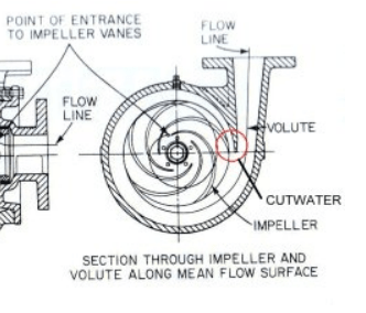

That's beginning to look like the pump casing isn't full at the start point or has some air trapped in it somewhere. whats the orientation of the discharge nozzle on the pump? (Any pictures?)

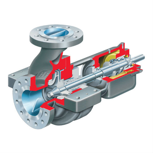

The suction is horizontal and the discharge is vertical as shown below:

I think an area to consider is the potential some how for air to get into the top of the pump casing which then takes time to flush out with flow. see the section below. It might be top exit, but the opening is about halfway up the pump.
You are probably getting some flow going back through the loop which slowly fills the pump and that's when the pressure rises. in normal operation you won't be getting forward flow until the pump discharge pressure is greater than the system pressure. Then you start to get flow then the sir clears out and the pump recovers back to normal operation.
Now how you're getting air in there is an issue, but I think it needs to be investigated and see if you can change this somehow.

I might easily be wrong about the trapped air, but see if this works. Is there a vent plug on the top of the pump casing? Can you attach a valve and see if you have fluid coming out whilst pump A is working or not?. If you do my theory is wrong, but if you don't then it might be right.
LI, you have shown a side discharge pump casing, the pump in question is a top centreline discharge which are virtually self venting, one of the main advantages of this style, although air trapped by a check or gate valve is still a problem and can airlock the case.
