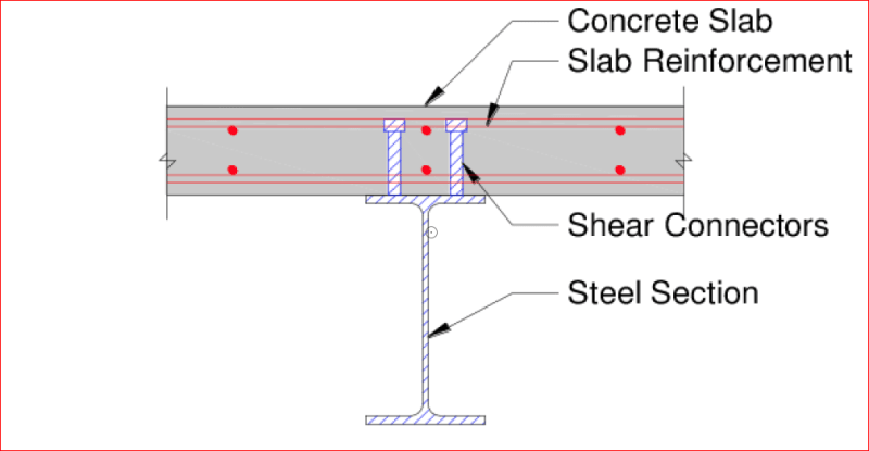

Your vendor may be thinking of a section in which the concrete slab acts compositely with the steel beam. That would be the more usual interpretation of the term "composite section". It is quite conceivable that a composite beam would be more economical than a W18x76, but if you have no experience or knowledge about composite sections, you will need the assistance of someone more familiar with composite beam design.
Check the internet for information on composite beams. Below is a section of a composite beam showing the essential parts.

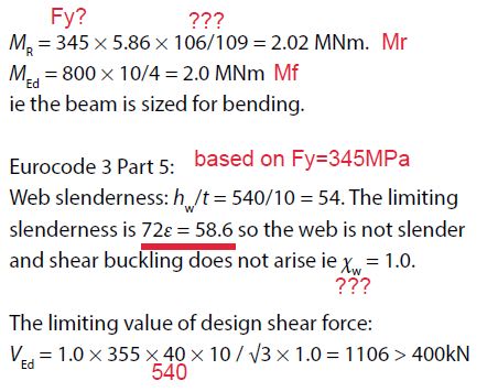

This is all about calculation of section properties seems not to mention weld.
thanks, the SMath is a work in progress... Regarding desertfox's submission... a couple of questions (I'm not familiar with the codes used).
What is the 345? MPa? and from where? and the factor 106/109?
Dik,
A reference for the steel would be BS EN 10025-2. As the flanges in the example desertfox posted are 30 THK it drops to 345MPa 16mm <= t < 40mm, ratner than t < 16mm.
As for chi, I'm not completely sure. Just had a quick skim through EC3, chi is listed as a buckling reduction factor referencing curves. Nothing with the w subscript though.
