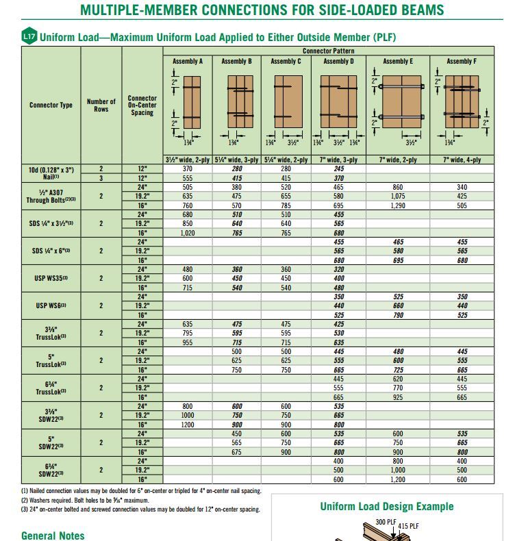

Why don't you want to nail the laminations together?
I never spec LSL beams except as bands. I have enough problems with way over-designed LVL's sagging on me. Don't wan't another animal to deal with.
Also, they simply don't stock them at the local yards.
I always worry about the side loading if you have to hanger a beam from another nail-lammed beam. A single beam eliminates this problem. I'm probably worrying about nothing.

As for the side loading. There are published calculations for LVL with side loads to determine what type of fastener and spacing is required
I know I've got my copy of TJ-9000 open right now, looking at this page. I'm not saying it can't be done its just one more thing to hassle with and then spec out on the drawing so that the contractor doesn't mess it up. A single ply beam is more convenient.
Simpson calls for 2-1/2" SDS screws for the HGU hanger series this will really only penetrate the first LVL ply.

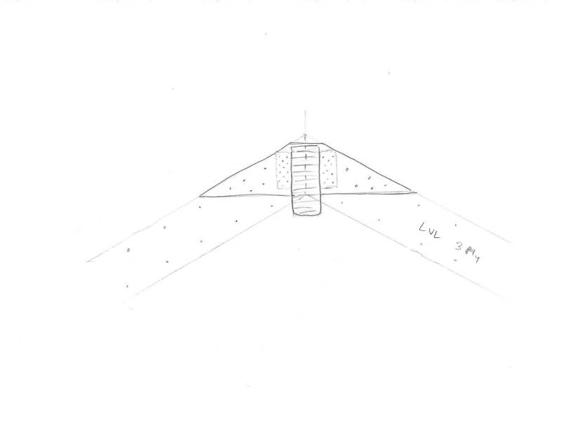

My idea might not have any merit but below is a quick sketch of the two rake beams spliced together and then the hanger attached to the splice:

I'm actually starting to think Kootk's idea of running two beams instead of one would be a much better solution. I've already spent way too much time mauling this whole thing over today but I'm still not satisfied with the solution.
A confused student is a good student.
Nathaniel P. Wilkerson, PE
Sounds like a better idea. I would not try that connection with that kind of load. Mine ridge reactions typically max out at about 2500 lbs. when I use that system.

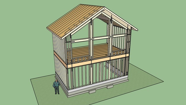

Here is what I have so far. I think I have all my load paths covered but I will maul it over during the weekend and gladly consider any feedback from the board. Somewhat of a non-standard portal frame (moment frame) going on, I'm still figuring out how to analyze it fully. My strap and holdowns are still pending my final lateral numbers. The ambiguity is caused by assuming a rigid diaphragm so the lateral load to this wall is somewhat governed by its rigidity compared to the other three walls of the room. How to assign a rigidity to this construct is where I'm scratching my head at the moment. More rigidity will attract more load which will drive up my straps and holdowns...

I've created a SketchUp model to help identify any further problems with the design. I just realized that the floor joists will not span the 25' of the room and a floor beam will be required at mid-span.
URL]
View model and download SketchUp model here:

Added the pad footings and a few more straps:
