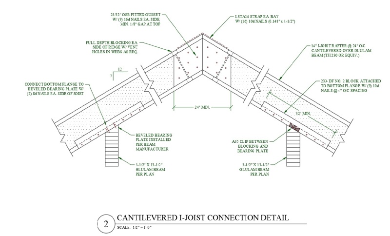

As and add on I've come up with a detail for the cantilevered I-Joist roof:
A confused student is a good student.
Nathaniel P. Wilkerson, PE
Looks good. However, it further bolsters my case on how difficult it is to work with I-joists. That detail would be much easier with dimensional lumber if it worked out spanwise etc.
Good point, the detail in the manufacturers called out for a twist strap at the bearing point on the beam, but I didn't want little tabs sticking down that would be visible so I had to devise a different method to make the connection between the beam and the I-Joist, bit of a pain
One could install a non-structural ridge board and some variable slope hangers for, perhaps, more conventional detailing.
Good point. I just checked the price on them and they are only about $5.00 a piece online. (Probably $10.00 from a lumber supplier) Much cheaper than I expected.
