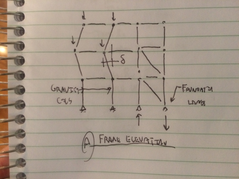

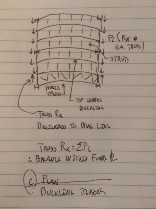

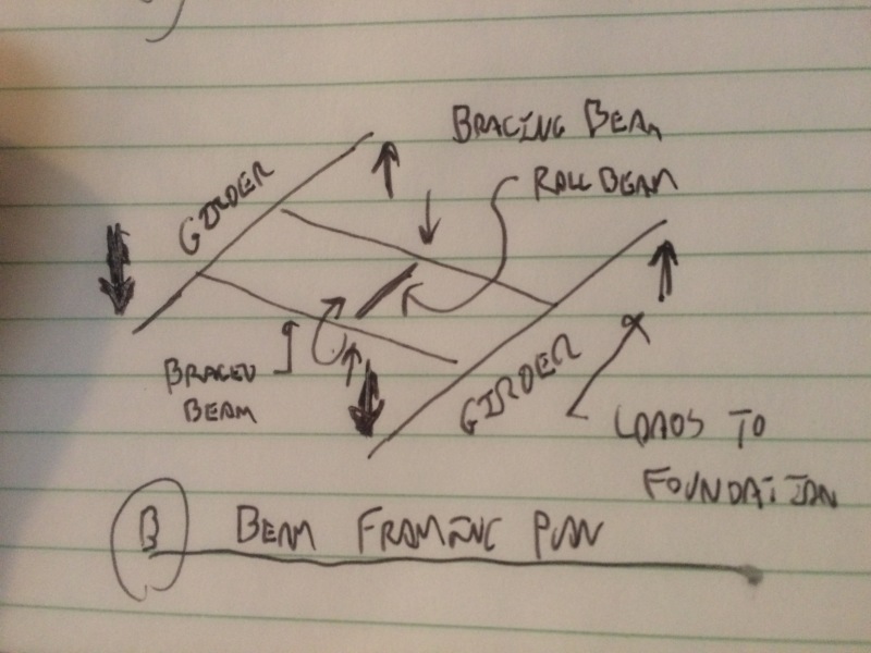

For illustration and discussion, I submit the three examples sketched below. They are:
1) The ubiquitous example of building gravity columns braced by a vertical truss. Load makes it to the foundation.
2) A floor or roof beam braced against lateral torsional buckling via attachment to its neighbor. Load makes it to the foundation.
3) Braced truss top chords sans shear diaphragm which I believe to be the particular case of interest to the OP. Loads get passed around some but may be resolved within the framing level under consideration. Kinda depends on what you've got going on for lateral restraint of the deck.

1) The entire load path would be evaluated for this case. In practice, this would be handled by the notional loads that we use as part of our lateral design algorithms.
2) This is a case where I would expect most engineers to only give consideration to the bracing load demand locally.
3) This is a case where I'dd expect most engineers to evaluate an extended load path if not the whole thing. In my opinion, the aggregate bracing demand increases the stakes considerably and it would be remiss for one to stop anywhere short of at least checking to see if struts and horizontal truss possess enough stiffness to serve as competent bracing for the truss chords.

Reviving this thread just cause I didn't attach the picture I mentioned. The attached sketch shows something similar. It also relates to the third case in KootK's first reply. In the picture, all green struts are connected to the bracing system but there is no eave strut, so I guess the top chord is laterally stabilized at the ends by the columns. This will cause weak axis bending in the columns (force shown in red). How would you handle this situation and is there a conservative / simple way in which you deal with this load in the column?
