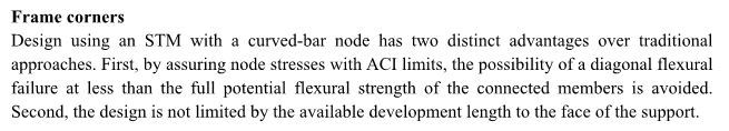

If you'd like to design to British standards, then don't use terms like "Standard Hooks." If you'd like to save a couple of inches on that footing depth and you are itching to publish an engineering dissertation on curved-bar nodes as well as field an extra RFI from the rebar detailer, go ahead with strut and tie modeling.

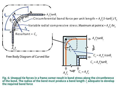

Forgetting about code rules and logic etc and looking at where tension reinforcement needs to be, we need tension reinforcement down the back face of the wall and in the bottom of the toe and the top of the heel.
I would have top and bottom reinforcement in the footing to provide the last 2 of these. The bars in the back face of the wall then need to develop past the top footing bars and also lap to the bottom footing bars in the toe with sufficient bend diameter to allow force to develop fully past the bend to form the lap with the bottom bars. The horizontal length of the wall bars needs to be in the same layer as the footing bars and below the support footing bars so as to not create a zone where concrete u=is being relied on to take the tension..

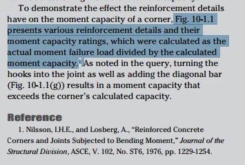

If you have a zero toe wall, you have an opening corner joint. Your statement that "a standard hook will work" is incorrect if the joint is to take the full moment. You need to study the details which KootK posted, which list the efficiencies of various types of joint reinforcement. Testing by Nilsson and others has shown that the double hairpins as shown in Figure 13-29 are really the only way of fully developing opening corner joints.
As I have presented methods that seem to be controversial, I thought I might expand a bit upon what I actually do in practice:
1) I don't use eurocode provisions except as an aid to my own understanding.
2) I use the CRSI joint detailing whenever possible (95% of the time) and don't bother with curved bar node STM theory in those instances except as an aid to my own understanding of joint behaviour.
3) When I have cause to stray from the CRSI detail, I use a spreadsheet that a colleague made at my request to investigate the joint using the joint using the curved bar node STM model. It's rudimentary and requires some manual parameter iteration. Maybe twenty minutes per run to set up and fiddle with.
4) When I use strut and tie models -- for retaining walls or anything else -- my goal is never to shave down material quantities. This is partly because, in my experience, STM never does reduce quantities. Rather, it adds to them. The goal with STM, at least for me, is to make my designs safer, not cheaper.

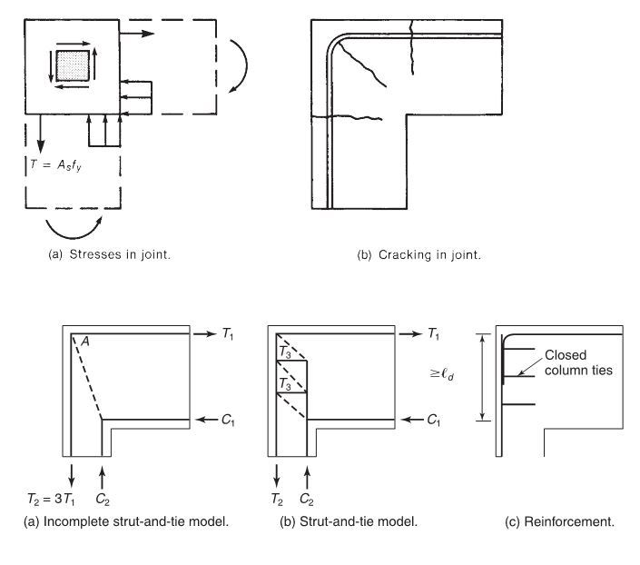

Figure 13-27 above has enlightened me. I have always followed the CRSI details, except I have typically omitted that diagonal bar. I felt if the bar from the stem wall into the footing is developed in both directions (above and below the construction joint), and the bars in the footing are developed on both sides of the stem wall, then there is no chance of failure.
I think I will start including the diagonal bar in my retaining wall designs.
Out of curiosity--is the problem with Figure 13-27 a strength problem (reduced capacity), or a serviceability problem (joint opens up)?

It's definitely a strength problem as the efficiency percentages quoted indicate [Moment capacity achieved in testing / Moment capacity calculated by conventional procedures * 100]. The crack widths quoted are, I believe, the values estimated to accompany a serviceability load level (55% Mn for example as indicated). At serviceability crack widths of 1/4", it's pretty tempting to call that a failure as well from the perspective of corrosion and water tightness (where required).

Regarding the diagonal bar in Fig. 13 (b) has anyone found them to cause difficulties with placement or consolidation
I'm assuming that we're talking about the wall corner detail below. I've only attempted it in large scale industrial applications where there was plenty of room and there were no complaints. I would wouldn't be pitching it in your standard 8" stem wall or anything like that.

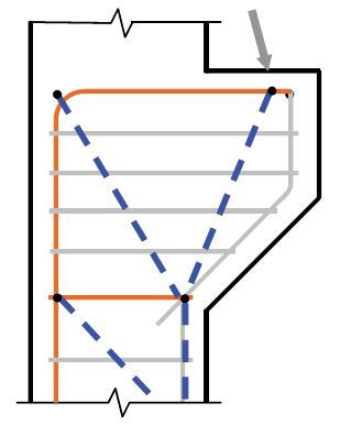

Do we provide a full vertical lap splice for the hooked end of haunch/corbel reinforcement?
I do in fact. Obviously, though, I realize that there are older, empirical methods (ACI shear friction etc) that do not require this. Strictly speaking, if you approach it from a strut and tie perspective, it's tough to avoid the need as you wind up with another of those situations where you need to transfer rebar tension force around a bar bend. The sketches below are taken from the curved bar node article that I posted above and MaGregor's text.

Absolutely at roof level edge columns. We don't typically bother at other conditions where there is beneficial clamping action available from columns both above and below. That said, I'm sure that these connections deserve more attention than they typically receive. And in seismic country, they get it. The sketch below is taken from MacGregor and illustrates the demand.
