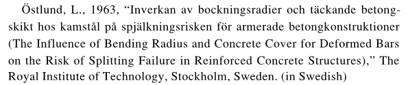

Tom said:
Do you know of any practical tests?
I know of this one. It requires one to read Swedish however.
