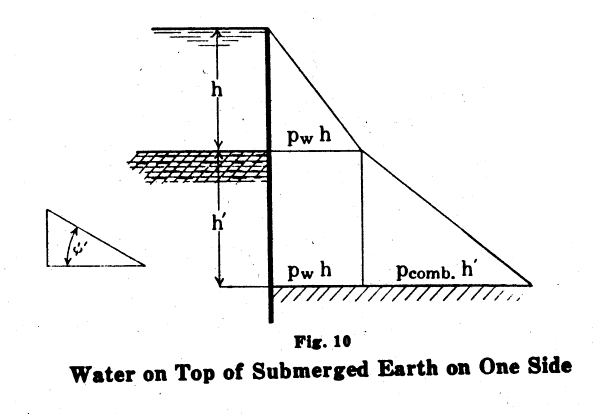

For us that don't do these bio retention things every day a cross section drawing would help. I'd be reluctant to design for active pressure if saturation is in the picture. More likely the pressures will be equal to density.

Thanks - I agree. I am basically designing it as your diagram shows. I was really hoping to see if the drainage layer provided would allow me to exclude the hydrostatic pressure (seems unlikely). I didn't want to be too conservative but it sounds like this is where we are at. I totally overlooked the media mix info for giving me the weight of the backfill.

1) I read this to mean that you are relying on software, not an understanding of pressure from "submerged earth", to "solve" the problem.
2) Hope that you have raised that water level now.
3) You will have to find out... otherwise garbage-in-garbage-out from the software package.
4) That is not how pressure from "submerged earth" works. Hydrostatic pressure + submerged earth pressure is "worse", not "better", than "dry" earth.
5) Not conservative at all.
6) Yes, check that... but the media is only 3' thick. There is quite a lot of "rock" underneath it to provide passive pressure.
7) Don't fool yourself. Get help on this project, nothing wrong with that. What is "bad" is not to recognize when help is important.
