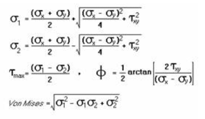

Can someone explain how RISA-3D calculates Plate Principal Stresses? Specifically, how does it derive σ[sub]x[/sub], σ[sub]y[/sub], and τ[sub]xy[/sub] for use in the Mohr's Circle calculations that lead to σ[sub]1[/sub], σ[sub]2[/sub], τ[sub]max[/sub], and σ[sub]Von-Mises[/sub]? The methodology is described here. The Plate Forces and Plate Principal Stresses for a 2.25" thick plate output by RISA-3D are:

Attempt #4: at this point, I gave up and backsolved the RISA-3D Principal Stress results to find σ[sub]x[/sub], σ[sub]y[/sub], and τ[sub]xy[/sub], and it led to this:
σ[sub]x[/sub] = f[sub]ax[/sub] + f[sub]bx[/sub] (excluding warping) = 16.02 ksi
σ[sub]y[/sub] = f[sub]ay[/sub] + f[sub]by[/sub] (excluding warping) = 31.54 ksi
τ[sub]xy[/sub] = 3.89 ksi; a number I can't derive using any combination of F[sub]xy[/sub], Q[sub]x[/sub], and/or Q[sub]y[/sub]
Resulting error: 0% for σ[sub]1[/sub], 0% for σ[sub]2[/sub], 0% for τ[sub]max[/sub]
Given that f[sub]xy[/sub] = 0.186 ksi, f[sub]xz[/sub] = 1.382 ksi, and f[sub]yz[/sub] = 6.548 ksi, how did it come up with 3.888 ksi? And why would the warping moment be excluded?

But shouldn't σ[sub]x[/sub] and σ[sub]y[/sub], for use in the equations below, also include axial stress and warping moment stress?
What I'm trying to understand is how RISA-3D arrived at the Principal Stresses (shown above) using the Plate Forces (shown above). It appears that RISA-3D left the warping moment out of its calculation of σ[sub]x[/sub] and σ[sub]y[/sub], and I have no idea how it got the shear value of 3.888 ksi.

"I believe the Txy value should be based on a combination of Fxy and Mxy." Bingo, thanks! So the warping moment M[sub]xy[/sub] gets added to M[sub]x[/sub] and M[sub]y[/sub] for concrete reinforcement design, but it gets added to τ[sub]xy[/sub] for finding Principal Stresses in steel. That's odd.
The equations below caused my results to match RISA-3D output:
σ[sub]x (top)[/sub] = f[sub]ax[/sub] + f[sub]bx[/sub]
σ[sub]y (top)[/sub] = f[sub]ay[/sub] + f[sub]by[/sub]
τ[sub]xy (top)[/sub] = f[sub]xy[/sub] + f[sub]bxy (warp)[/sub]
σ[sub]x (btm)[/sub] = f[sub]ax[/sub] - f[sub]bx[/sub]
σ[sub]y (btm)[/sub] = f[sub]ay[/sub] - f[sub]by[/sub]
τ[sub]xy (btm)[/sub] = f[sub]xy[/sub] - f[sub]bxy (warp)[/sub]
