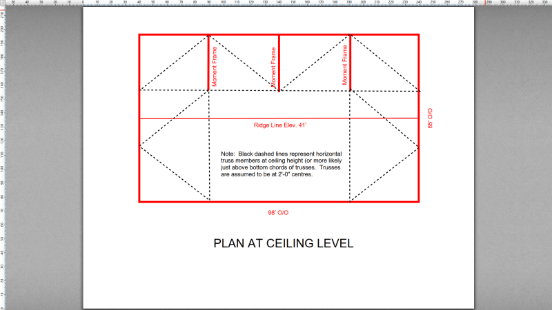

I have a 98' wide x 65' deep municipality building with 16.5' wall heights and a 41' tall ridge line. simple gable roof spanning 65 ft with the trusses spliced 2/3 depth over steel beams. I have 20.5' long moment frames located at 1/4 points that are parallel to the trusses and situated in the back third of the 65' deep building.
I want to use the ceiling that attaches to the bottom chord of the roof trusses as a lateral diaphragm and then transfer that lateral load to the 4 moment frames and the two gable ends. the ceiling will be 5/8" drywall. I have about 550 plf of wind horizontally along the top of the stud framed exterior wall.

I agree that a drywall ceiling is marginal as a diaphragm. I don't like it. Plywood over the entire ceiling seems a bit much too. Perhaps horizontal trusses in the plane of the bottom chords of the trusses would be worth considering.

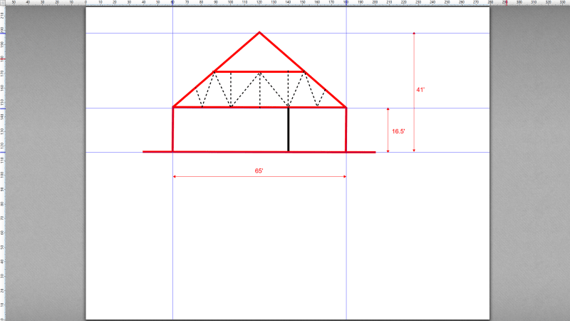

I'm not quite clear on the 2/3 splice over steel beams. Doesn't look like steel beams are required, but I may be misunderstanding the geometry. The following is a sketch of what I am suggesting.
BA
BA, good sketch. Instead of spanning the trusses 65' I have them spanning 44' and splicing over a steel beam line going the 98' dimension. The steel beam line also has column at 1/4 points which doubles as my moment frame columns. I guess ultimately I'm not familiar with bottom chord diaphragm truss bracing. How do you detail that and how does that attach / transfer to the moment frames? And knowing my trusses span 44' to steel and splice with another 25' span to rear of building
Okay, now I understand what you meant. The rise of the roof is 41' less 16.5' = 24.5', which means your roof has a slope of Edit: 24.5/32.5 = 0.75 = about 9/12. That is a slope of 37o. For transportation, you may have to consider piggy back trusses because they are so high.
I like the idea of a steel beam and columns at the interior end of the moment frames. The trusses could be spliced at the 2/3 point as you have suggested, or alternatively, at midpoint of the roof, making all trusses 32.5' long. In the latter case, the rear trusses would cantilever about 65/6 = 10'-10" to pick up the front trusses, not a problem given the depth of truss required.
Members of the horizontal trusses could be timber, and as dik suggested, supplied by the truss supplier or they could be steel sections for ease in field splicing. They would be fastened to the top of the bottom chords of each truss. In that way, they would be laterally braced at every truss, so should be adequate in tension or compression.
The truss fabricator must ensure that web members are positioned so as to miss the truss diagonals. That should not be a problem, but needs to be carefully checked at the shop drawing stage.

Drywall is not adequate as a diaphragm to resist 550 plf lateral load at the top of wall. The roof system makes an adequate diaphragm if the trusses provide a tension tie across the building. They would do that if they span 65', but handling such a long truss may be a problem. If trusses are spliced at midspan, or at the third point, the splice must provide a tie to prevent the roof from spreading. With the height of truss specified, it will likely be necessary to use a piggy-back system.

If you are going to splice the trusses, you need a beam and columns, but not necessarily moment frames. My current thought is that the roof diaphragm could easily span 98'-0" and be supported by the end (gable) walls.
The gable walls will be shear walls and, because of their height, will need lateral bracing, possibly lateral support at ceiling level.
