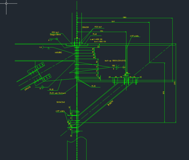

Hello all,
i am working on a girder beam(1000X420X40X32) to column web(25mm) connection with a big shear load(500KN) and transfer load(+/- 1000KN). i am using shear end plate (32mm) to transfer the load. a very thick endplate needed after considering prying action( M20 steel bolt is used). I have a little concern about the rotation ability for the girder beam as the end plate is too thick.it may become a semi-rigid connection which can take some moment which i don't expect to see. but from another side it seems impossible to use a thin end plate due to the heavy section and big design load. i am wondering who can give some suggestion and opinions for this detail? i attached the detail for detail information. and are there any good articles addressing end plate connection rotation ability?
thank you!
Looks like a conventional connection, albeit for high loads. I've used similar connections often. I generally use the AISC method to determine minimum plate thickness to use for prying action. A little thicker plate is cheap when it comes to added bolts. In these environs, M19 bolts are less costly than M20. Do you need a CP weld? That connection will not act like a pinned joint.

CP may be not required, the web thickness is only thin, there won't be a big difference between fillet weld and CP. "the connection will not act like a pinned joint" is really concern from me. i plan to add a knee brace under side of girder. in this way, i can release moment of girder end.
Thank you
A knee brace may not help, and may make things more difficult. Can you not connect to the column to develop the moment resistance? The column moment is about the weak axis and would be determined largely by the rotation of the 1000 built up girder, which shouldn't be a lot.

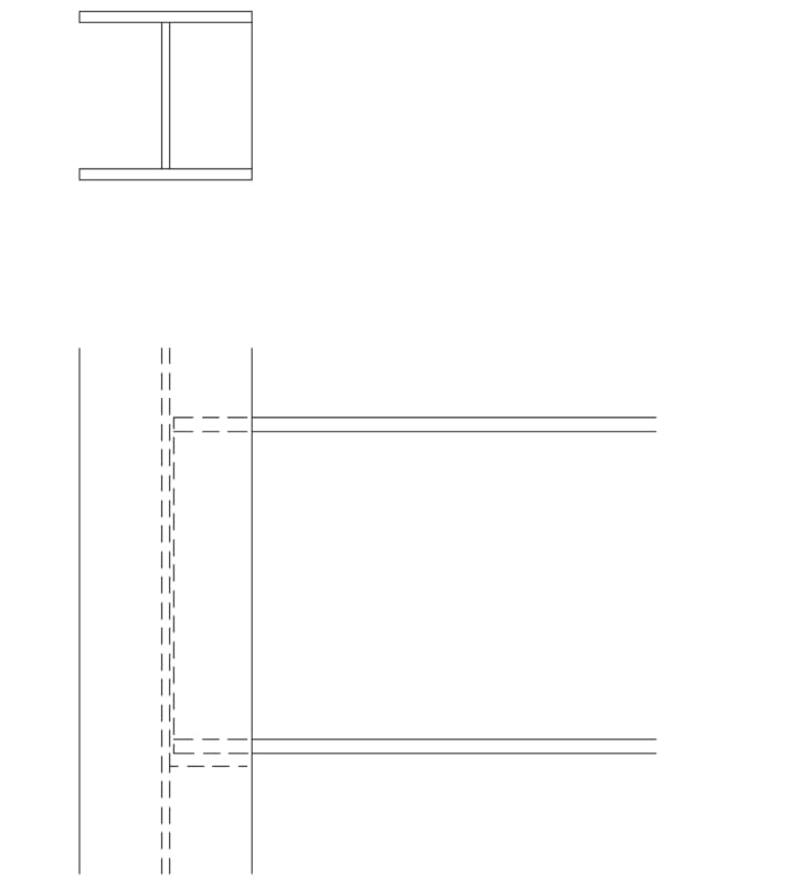

Is there a reason you can't use standard clips on the 1000mm side? Why the endplate?

i am struggle with this, as the girder connect to web of column, it won't be a real moment connection. the full rigid moment here is around 2200KN*m as per analysis. I think the real moment will be much lower than this number, may be 50% of this number, but it's very hard to say. This's the reason i try to use knee brace(250UC79), after adding the knee brace we can assume it's a real pin connection at girder end(tension under gravity), the knee brace will be compression link under gravity load. the moment happened under normal operation load combination which makes me cautious to estimate the moment at the girder end. I attached my knee brace detail, seems not such bad. and May i ask if you have other suggestions regarding this joint connection?

Can you plate across the toes of the flanges and use a stiffener plate, too?
Can you use a bearing connection for the girder and avoid a moment connection completely? The use of clip angles (JLNJ suggestion) will greatly reduce the moment.
I don't see how you can possibly justify that as a pinned connection. It would absolutely behave in a semi-rigid manner. I'd first start asking the question whether semi-rigid is a problem here. If it absolutely is then I'd start chasing a better connection.
Your original connection is commonly accepted for this scenario. It has some ability to attract moment, but opposing end-plates are one of the best methods to transfer axial loads through column webs. We're obviously working with different codes, but you can make the original detail work just fine. Steel is fun because you can control the load path by sizing your welds/connecting-elements. That will draw the axial load in certain proportions to the desired elements.
you are right, that's one of my concern. this will be semi-rigid connection, but it's hard to estimate the how big moment it will be .if i assumed 50% of full moment value , check this connection as per flush end moment connection following AISC DG-16, it will be failed. i try to find a way to solve this problem, even it's a bit conservative.

I consult with my team members as well, that's true, they used this kind of connection to transfer big transfer load before as well. but seldom to be used in such deep girder. that's why i am considering to add the knee brace underside. this is additional constrain, but i think make the connection safer....
I prefer to let it yield and then deal with it.... [tongue]
I wouldn't normally add a knee brace. It will attract too much moment, I suspect and you have the weak axis of the column... Deal with the connection and try to make it as flexible as you can (unless you need the moment resistance for other reasons).
sorry what does this mean?
it's had to use bearing type due to site condition and the steel structure. i can't find thick enough angle to resist prying action here.

Thank you so much for the suggestions and questions, i appreciate it a lot. By adding the knee brace, the full moment value reduced to 50% of no knee braces by analysis. considering it will be a semi-moment joint, i think the girder beam connection will be strong enough.
may i ask, are there any technical concerns from you for the knee brace option except more complicated of installation. i am working in heavy industry, the important equipment is sitting on this girder. Client should be ok with erection...
Thank you!
ArcherC, i think that when dik said that the knee brace will attract too much moment, he's not talking about the moment exaclty at the Girder-Column connection but the moment created by the binary of tension on the connection and compression on the Knee brace. I also think that this moment will be much greater since the connection with knee brace is much stiffer. If this Moment is not a problem to your column then the connection with knee brace is IMO adequate.
can you do something like...
