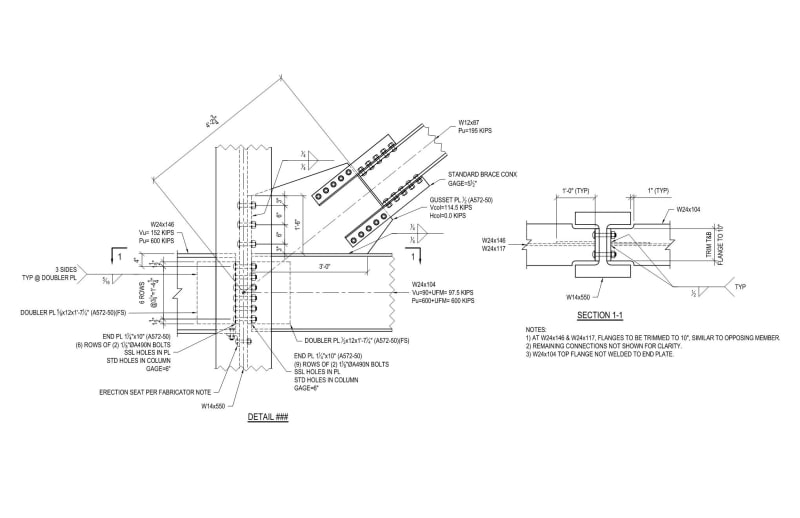

Hello all,

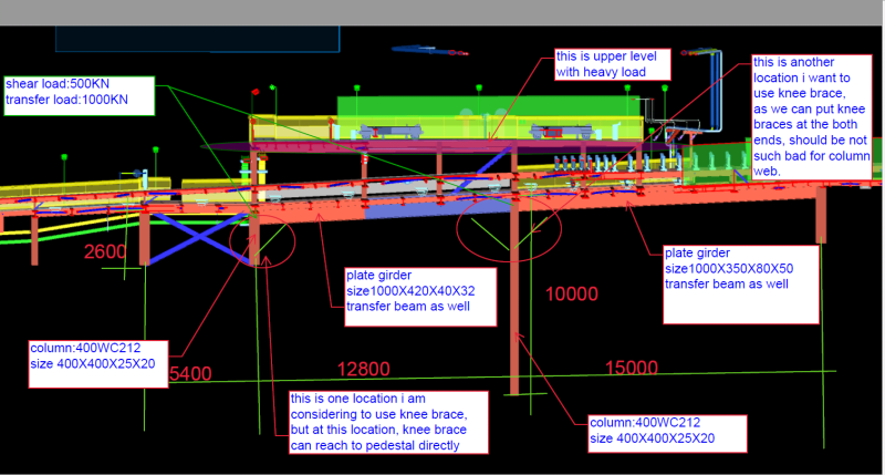

i am working on a girder beam(1000X420X40X32) to column web(25mm) connection with a big shear load(500KN) and transfer load(+/- 1000KN). i am using shear end plate (32mm) to transfer the load. a very thick endplate needed after considering prying action( M20 steel bolt is used). I have a little concern about the rotation ability for the girder beam as the end plate is too thick.it may become a semi-rigid connection which can take some moment which i don't expect to see. but from another side it seems impossible to use a thin end plate due to the heavy section and big design load. i am wondering who can give some suggestion and opinions for this detail? i attached the detail for detail information. and are there any good articles addressing end plate connection rotation ability?
thank you!
Thank you so much for the sketch. it's hard for me to meet this situation.
HI Human909,
Thank you so much for the sharing.

I totally agree, the connection need to be designed with considering the whole structure. i am the engineer as well. i attached the bay of the structure with dimensions. let me know if you want to see more information.

Good morning All,
I am wondering if anyone has opinion or preference for the without brace option and braced option?
at the same time, i have another question, for the 10m column , i can rotate it 90 degree, in this way the girder will connect to column flange directly, Does it will help load transfer ?
Thank you.
I remains unclear about what you want to achieve. You seem to be struggling to design a suitable pinned connection to your satisfaction and are instead choosing to add members (knee braces) to change the structural behaviour to avoid having to design the simple pin connection.
You either need to figure this out yourself or provide EXTENSIVE information on what loads, what combinations and what you are having difficulty achieving. From where I sit the original connection seems mostly suitable.

Good morning human909 and all ,
I consult a few engineers within my team these days, the common agreement is adding knee won't help a lot to release my concern but make assumption more complicated. same as yours.. the without knee brace should be the proper solution here, i will consider some reasonable moment this end plate will attract, i have some ideas regrading to how to consider it, and will post here after i get a number. and 2200KN*m moment is an extremely number from fully moment connection set in analysis model. won't happen in reality.
i have another item want to get some opinions as well. for the end plate connection without braces. i am thinking if i should extend end plate to bottom flange of girder or not ?
The advantage of this is "girder web plate will have less yielding concern as the girder only coped at top flange"
The disadvantage of this is" it will attract more moment by connection to bottom flange"

I think you should conclude this thread and consult your IRL peers/management. For clarity's sake, here is a connection design I am working on right now that is very similar to yours. This connection concept is commonly accepted in non-seismic regions in the USA. You will need to adapt the concept to your local code, client preference, and preferred industry practice.
DrZ is giving you everything you need in this thread.
As noted by others, your original detail looked reasonable. The knee-brace is a bad idea and should be abandoned if not already.
Your original question was about the end plate being too thick and not allowing end rotation. Consider the following:
[ul]
[li]I assume your beam designation 1000x420x40x32 means you have a beam 1000mm deep, 420mm wide, 40mm flange, and 32mm web[/li]
[li]The moment of inertia of this section is 9822x10[sup]6[/sup]mm[sup]4[/sup][/li]
[li]Where the beam connects to the end plate it looks like you have about 860mm of depth engaged. The moment of inertia of the engaged web(860x32) is 1696x10[sup]6[/sup]mm[sup]4[/sup][/li]
[li]The bending stiffness of the engaged web is 17% of the stiffness of the beam section. So without considering flexibility in the end plate, you've already got a connection that is fairly flexible relative to the beam[/li]
[/ul]
Somewhere in this thread you mentioned you're designing the structure as well. If the software you're using allows it, try adding a partial moment release at the end of this member and see what kind of moment it attracts. If you feel it necessary, you can always design for the end moments to be transferred through the web.
Something that I don't think has been mentioned, and I think about often is the connection on the left. With the deep end plate and gusset, that connection is likely much closer to being fixed than pinned.
One last thing, why the PJP on one side of the web and the 8mm fillet on the other? You're indicating 8mm effective throat on the PJP but providing 5.7mm effective throat with the fillet weld. You should keep the weld strength balanced. And for the thickness of the web/end plate and the uncertainty in the end rotation with the thick end plate, I would be using a minimum 10mm fillet.
