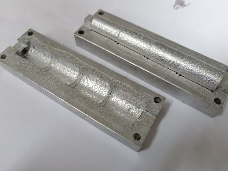

What is a simple way to apply a uniform coating of rubber (thickness 0.15-0.35 mm) to a mandrel?
The mandrel is essentially a cylindrical shape and made of aluminium.
The coating is a urethane rubber:
Tricky with it being so thin .
Build a cylindrical female mould that splits in 2. Experiment with release agents and surface prep.
Or maybe paint it on and then turn it down to size on a lathe, if it is a one-off.

I actually built a mold, with cavity split in half and a core.
Problem is material didn't cure after closing the mold:
I was looking for alternative techniques, and in fact I considered dip molding.
But the pot life is really short and I don't want to waste material for the bath.
Will try spinning the core / mandrel while pouring material over, sort of like spin coating.

What material didn't cure? If it was regular single part silicone, then that's the reason. Two part/catalyzed urethanes cure in molds unless you left out the catalyzer.
