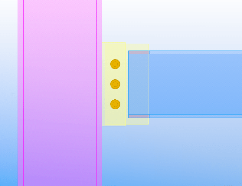

below is the connection that will show you details, connection plates are 3/4" thick mentioned by EOR.

Hi veer007
Have you another view of the section? Is it a “c” section you are welding, I can’t tell from one view what exactly you are trying to do. Are you welding the blue section onto the yellow bracket?
Both yellow are connection plates, the blue one is Girt HSS254x254x12.7 and Pink is w-column

So the yellow plates sit on either side of the HSS section?
No, one is a gusset plate and another one is the connection plate which slots the HSS tube.

Hi veer007
So the a plate is welded central in the HSS tube And then using bolts that plate is fastened to the gusset plate is that right ? Also how is the HSS section loaded when in position?

Do you mean that the EOR put said to design all connections for 1/2 UDL values but the code you're using doesn't have UDL values for HSS? If that's the case, stop guessing. Stop trying to use rules of thumb. Stop doing anything but sending an RFI to the EOR and requesting a reaction because they failed to give you one. You're designing connections on behalf of the fabricator - the EOR is responsible for analysis of the structure. Get the data he/she is required to give you and don't roll the dice. It's not worth it for you, your employer, or the people who may one day walk into that building.

This is a bit off topic, but I would prefer to see that connection made with a WT or an end plate welded to the HSS so that the shear is directly transferred to the web of the HSS rather than through bending of the flanges.
